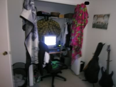

I am about to begin trying to make this room work better for mixing...Pretty much ONLY mixing. I may record vocals in here too, because I guess I want to deaden it alot. As you can see, I'm going to have my speakers in a closet with lots of clothes in it. I am going to treat the doors, the area behind the speakers, the ceiling outside the closet, the wall directly behind me. Is this a good idea, or is having the speakers in a closet going to mess with things? I seem to have a phase issue at around 50hz, the note becomes very faint.
Oh, excuse the blankets and stuff...I'm experimenting with anything I can get my hands on to see how it alters sound...I packed a bookcase with blankets and pillows and covered it in a tight sheet to see if it did anything for bass.
