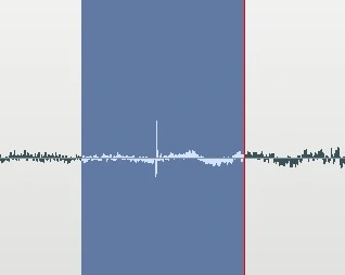

During a point of recording, A high volume, possibly high frequency, high volume bias resonates off the head, as the tape is MOVING. It's key to understand what's going on here. Inducing a voltage directly ONTO the tape. This has to be a LOW voltage BTW. Keep in mind the tape is CONDUCTIVE, and keep in mind that it has a polyester backing, now realize the capstan is grounded, and about 21mm from the head in tape travel. Audibly this appears to create static discharges that you can audibly hear (a fraction of a second later) usually after loud high frequency cymbal crashes.
If you would like to actually HEAR an example of this infection yourself, There are literately hundreds in not thousands of professional recordings sold today on the market, with these infections. Most studios of course would not distribute music having sever damaged recordings as I'm sure no artist would approve much less the audience, however there are those situations, probably in a specific time period where people didn't really understand what was going on. So it's going to be the lighter cases that made it onto professional recordings for the most part. I like to use the example of the beastie boys, off the pauls boutique album shake your rump.
This song was recorded in sections, in what sounds like different equipment for those sections, in addition to the entire structure of the song changing throughout the song, explaining why it's not simply a constant infection. You can hear static pops that follow cymbal crashes at the following times.
in seconds 3,8,203,300,305,309,314 While they are weaker in that ending of the song, it could be because of the volume of that crash in the recording appears to be lower volume, but it's certainly there.
These noises will STAY on that tape, and because of the way that magnetic fields work and affect surrounding material, will align the domains on the capstan IN THAT ONE SPOT. They can stack if the same infection lands on the exact same spot, or they can end up making multiple static pops on that same capstan at different times after different loading times. I think something that might be throwing people off when I'm trying to explain this, is the idea that the capstan then becomes a magnet but that's not exactly how it turns out, as it will damage the very purity of what was originally suppose music or silence and eventually put multiple infections on that one capstan. It's not our simply understanding of how a magnet works in the way the capstan gets infected.
This is where I probably confused you with using a commercial bulk tape eraser. To better explain, if an entire has gotten to the point of infection, it's clear to me, in my experience that a bulk eraser might miss percentages of the tape, allowing the infecting to once again regrow. Maybe it's possible that the static discharges are only aligning a small section of the domains on the capstan.
The end result is the same regardless, if you have gotten to the point where you have even just ONE hot spot on the capstan, it will spread and multiply, and grow, in both volume and position, until it destroys the media, That's the last section of the definition of VIRUS.
To be clear, it might start out as an anomaly, but can quickly escalate to where it's able to copy itself, and destroy the data. That's a virus.
Play that infected tape in a new deck, and you will infect it very shortly. Play a new tape in an infected deck, and you will infect that tape. Because it's origination was sound and tape deck mechanics timing, it can replicate through an audio dub as well.
I hope this better explained some details. I additionally have a screen shot of one of the infection points from that beasti boys track, and I'll TRY to post it.(new here, not sure how) You can see from it's frequency it's VERY high, and very high in volume compared to the other data.
