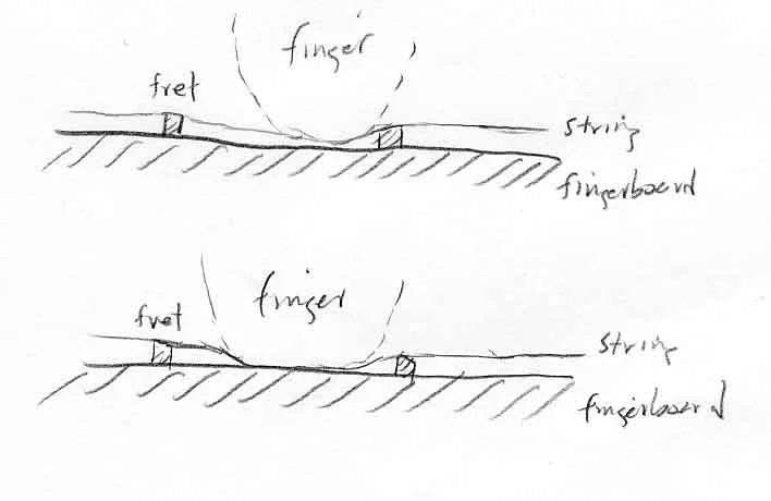

To touch on the off topic point here - finger pressure can make a difference in intonation, between players and probably even between fingers of an individual player, especially in classical guitar. Even though the fingerboard stops the travel of the finger, increasing the pressure can deform the finger pad and continue to put more tension on the string, raising its frequency.
From what I have experienced, this effect seems more prevalent on electric guitars with light gauge strings. The lightweight string offers less resistance to finger pressure and is more sensitive as a result.
I have a PRS 24 with 9.5 strings and it seems very noticeable. I have a Gibson Lucelle with 10 strings and shaved frets where it is much less noticeable.
Ed
