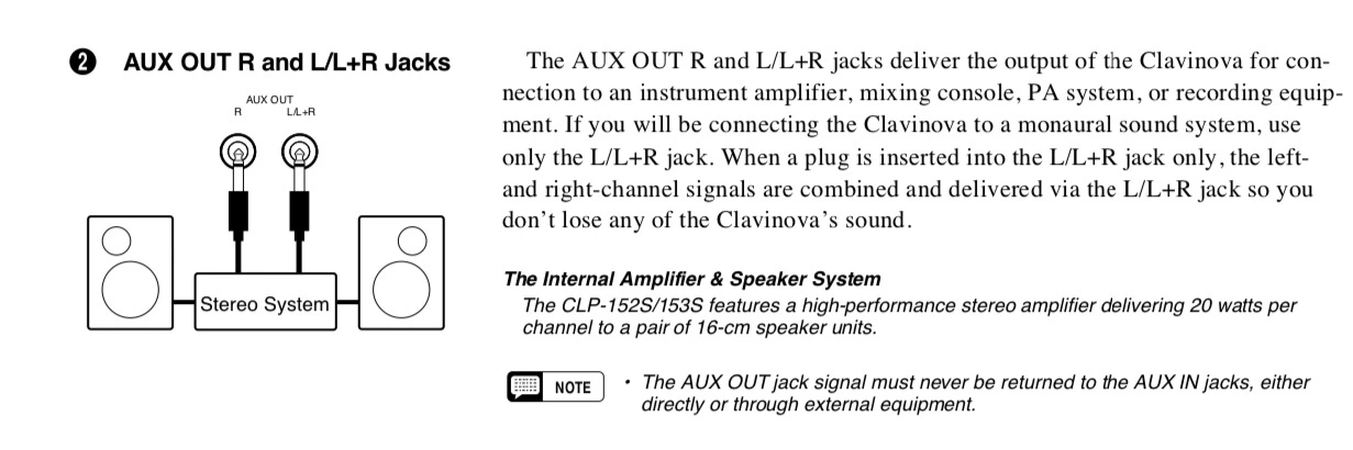

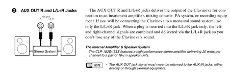

According to the manual the 153s has a pair of auxiliary outputs for recording.
It would be much better to use those.
If you can get an interface with a pair of 1/4" line inputs then you'd need a pair of 1/4" to 1/4" male to male cables. (guitar leads...).
If you go with ecc83s suggestion above then you need a pair of phono/rca to 1/4"

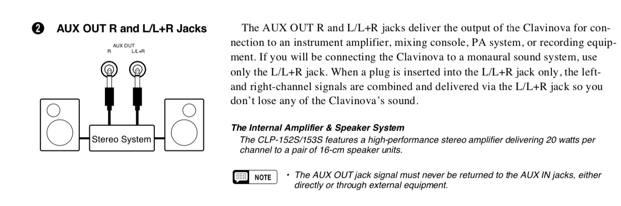

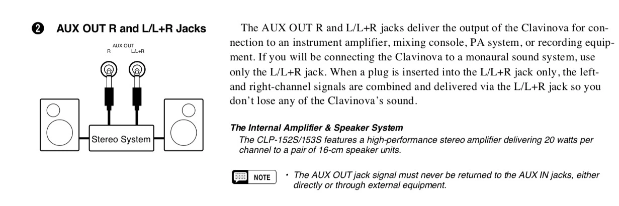

My God, I never realized what connectivity my piano offered. I had it against a wall for 11 years and did not bother checking for extra ports not visible to the front side. That makes things a lot more convenient to record. I still have to invest on an interface i guess. I own a guitar (with an amp of course), so it'd be even more worth it if the recording quality is better than the one the amplifier already offers. The amp is a Blackstar ID:30 TVP with both emulated line output and USB for recording. Could a 100$ focusrite top that?
