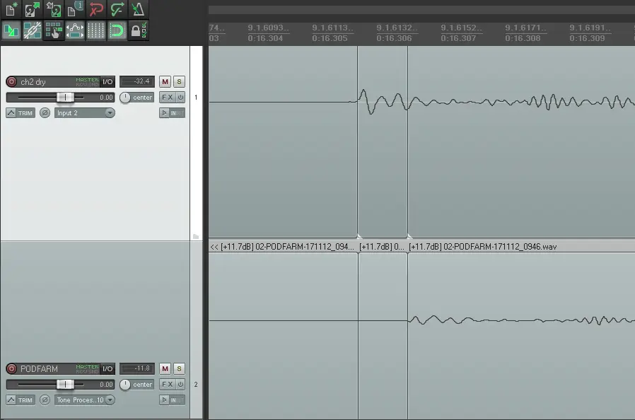

I ran some little test on my Line 6 UX into Reaper.
Track 1 was the Mic direct (ch2= dry)
Track 2 was the Mic through PodFarm (parallel 9&10 = real time FX- using a Preamp Plug & LA2A compressor plug)
I measured 1ms difference between Dry and "RealTime FX".
1Milli-second sounds impressive and looks impressive on the waveform.
Anyone have the Clarett or Thunderbolt that could post a sample like this, Im curious if they've improved this latency using the real-time FX?
I might have asked it before but am curious.
My interface is 2009 ish and USB 2(using a USB3 port) Windows 10 and the Reaper ver preceding this months current version.
Driver 32 44.1, buffer 128, bit24, "extra small" buffer is normal setting.
Seems I can still hear some slight phasy-ness if the two are equal volume but I usually only have one on at a time usually with real time fx turned on. In short its the best it can do....
1ms .....can a new Thunderbolt interface improve this latency? Or would a newer pc help more?
Im also wondering if the UA Apollos "real time FX" are the same and maybe 1msec is about as good as it gets?
Below is just me saying TEST into a mic. The top waveform is DRY and the lower waveform is the same going through real-time fx (preamp and la2a plug)
