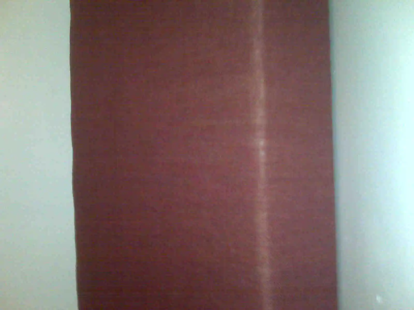

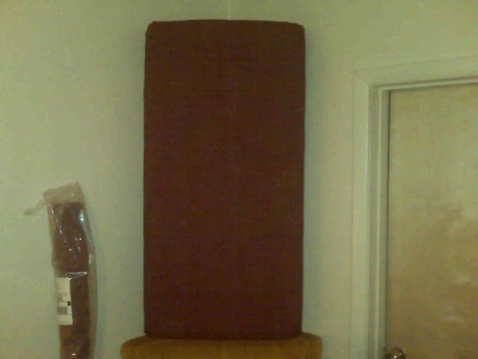

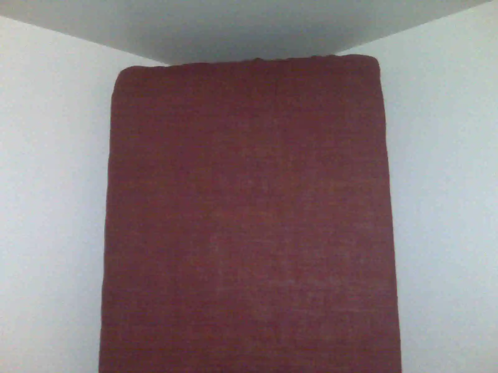

dunno but shure would be nice to see the finished product lol Here is one I did tonight 4" of a Rockwool type insulation so far so good only took me about a half hour each to build... pic quality is crap used my cell phone for it lol
