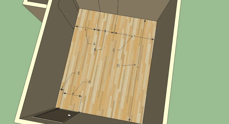

Ok hype, I have some questions for you. I'm ready to draw some instructional diagrams, but I need to know some stuff first.
1. Can you call SPI, and see if they have any "Knauf " 3lb density rigid fiberglass in 2", 3" or 4" thick 4'x10' panels. This is what I bought from them so I know they carry it. If not in stock, can they get it from another of their warehouses. It would be far better to get this size and cut it. I've never heard of the brand you mentioned. If you can't get the Knauf brand, ask the people at SPI, IF, the brand you mentioned is 3 lb per cubic foot density.
2. What kind of building skills do you have? Ever used power tools? Do you have any? Do you have any tools at all? The reason is simple. There are many ways to do simple things, so I have to match my descriptions to your skill level and tool availability.
3. Where do you live? Is there a Homedepot kind of place around your vicinity? What about a "picture framing" business? I have a specific reason for that one. How bout any kind of thrift stores, or junk recycling place? Again, specific reasons. Any Walmart type places, or fabric places?
4. Do you have a garage big enough to lay out 4'x8' or so panels for cutting?
5. What is you budget for this project?
6. Do you have available help, for manuvering panels etc?
7. Who owns this building your studio is in? Will they let you fasten things to the walls/ceilings?
8. Are there any lights on the ceiling?
9. I need some specific dimensions of this room. I've posted a pic of what dimensions I need. Please refer to them by the letter assigned and measure them.
10. What kind of room is adjacent to the opening by the closet.
A - 58"
B - 36"
C - 58"
D - 15'
E - 5"
F - 32"
