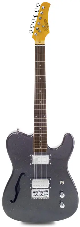

I like the looks of that black Metalflake with the Dream 180's in it-headstock shape is a bit different but no big deal. As it is it looks like a combination of a Thinline Tele with a bit of Rickenbacker jangle mixed in:cool:, I say go for it, play it a while and the decide if it needs active or not!

I actually have that exact guitar but in red.
I bought it just to have a cheap POS to play for my beach gigs and it's ended up being my current favorite guitar. I'm playing it at all my gigs right now; choosing it over much more expensive guitars.
If the only reason you're talking about putting in actives is because you're assuming the p'ups on it will sound bad .... then you may be surprised.
If you just want actives, well I've opened mine up and there's no need to add a cavity for the battery. There's enough room in the control cavity for one.
