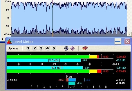

Here is a nice little photo of the waveform of the Blink 182 song "all the small things". I chose this song because it was aired quite frequently on mtv and every rock radio station in heavy rotation. You will notice the blue meter shows the average (rms) level. This particular section is during the chorus of the song which happens to be a bit louder than the rest of the song.
I know what's gonna be said so I'll spare yourself the typing.
"Blink 182 isn't even a real band. The meter is wrong. That's not real music"
Real music or not, it was on the radio. It was a radio single. I have plenty of more non-blink 182 radio singles I could break out for ya. Don't make me break out Audioslave or Godsmack or something like that.
here it is:
sjoko2 said:
Yup, overcompress and when it comes to radio play -- they will put some "standard broadcast" compression on top of it -- and your mix is gone to hell.
Sjoko2, that is a gross oversimplification.
Some....you mean like some nuclear weapons?
Radio broadcasters use gobs of compression, gobs of other processors..gobs and gobs of things that destroy the dynamics so that their radio station is the loudest "sounding" station in the area. One of the biggest problems is they hypercompressed and over limited material sends the error correlation into a tizzy.
