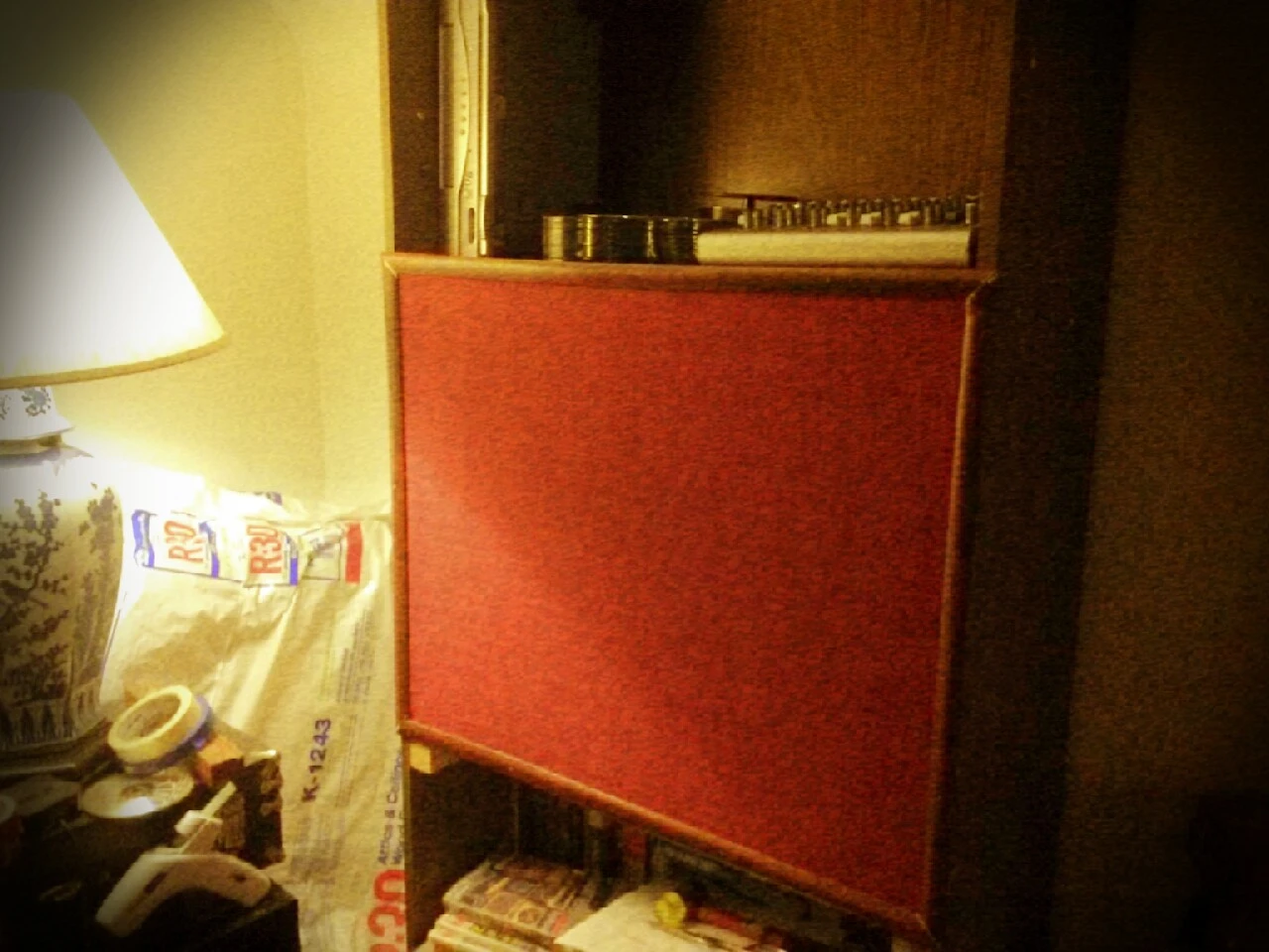

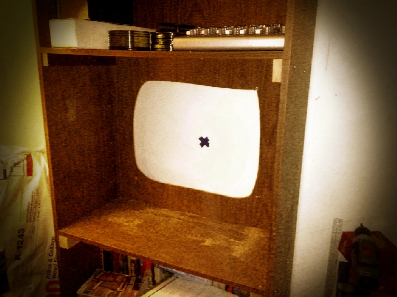

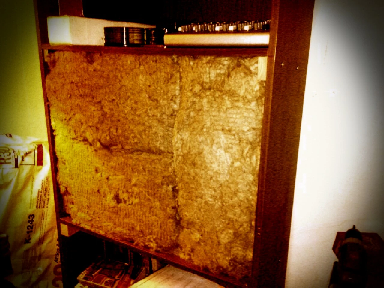

Small room, 13x11x7,. need the storage space so didn't want to lose the 2 freestanding RTA bookcases already in the room. Decided to modify the shelves for dimension, and the back for porting. Essentialy turning part of the bookcase into a basstrap frame, the cases will now present a 24"H x 18"W x 13"D shelf space filled with insulation and covered, at the 2 side 1st reflection points. 1"+ gap behind case. And i still get to use the shelves above and below the traps! Also planning on putting traps above the cases where the ceiling and wall meet.
Anybody see any big issues with this?
Anybody wanna see pics?
I'm attempting to do some weird methods for framing the rest of my traps. Its going to involve wire and hot glue!!!!!!!!!!!!!!!!!!!!!!! If the interest is there I might do some build post for that as well.
