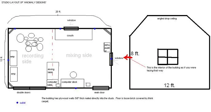

This is a layout of my studio. If you could where would you put it and why?

I'd prefer this would be a bass trap of some sort. I'm looking into how to build the membrane traps now... if someone has a link it would be appreciated. I would like to put them in the two corners of the 'recording' side of the room. Is this my best bet?
I'd work on deadening the wall behind the mix desk, imho.
build some proper bass traps with some other material, but if you have
no treatment at all on the wall behind the mix position you will probably have
a lot of trouble mixing.
I'd hang it like a curtain, say take 2 2X2s' and screw them together with
your feltish stuff inbetween, then screw the wood into the ceiling.
3 of these, butted up to each other, so you have three thickness
of cloth and 2 air spaces, should kill lots of reflections off the wall behind
the mix position.
ymmv
C>
