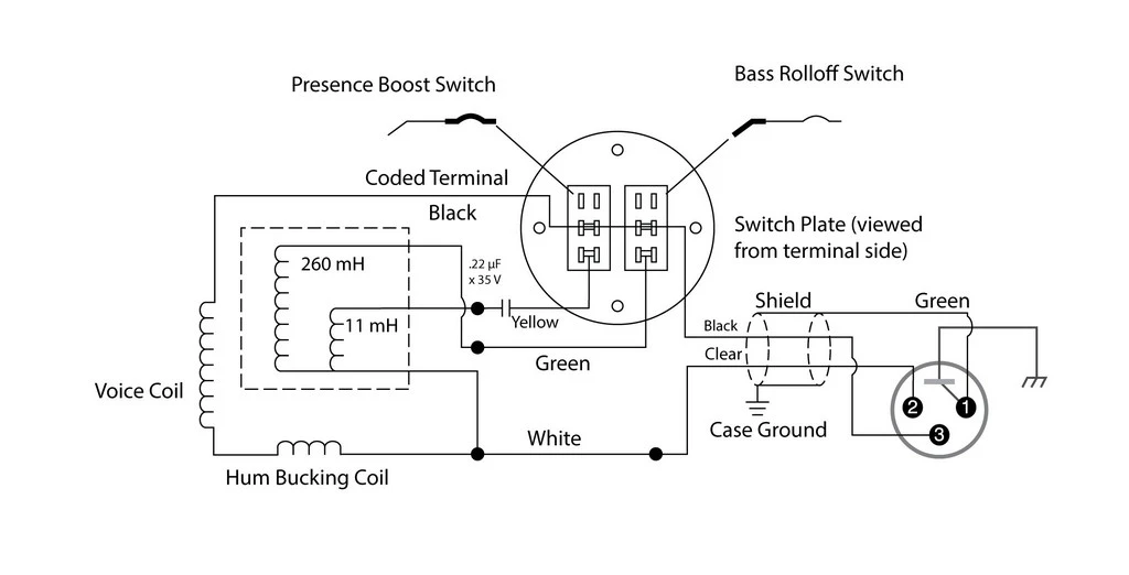

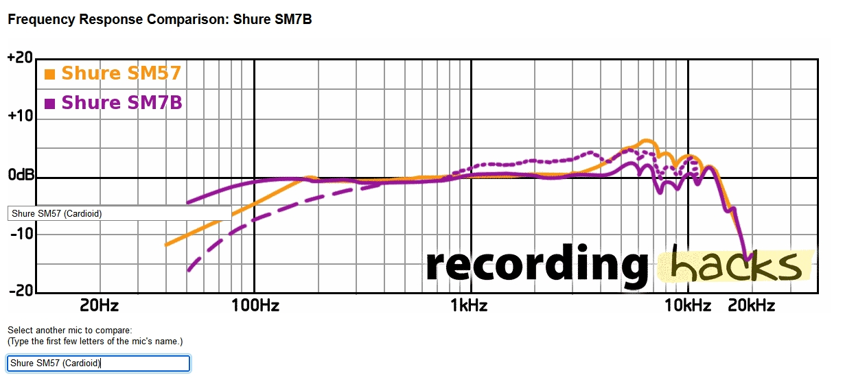

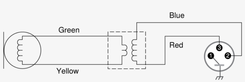

So many of today's products shared common origins, but then split off into a unique product. Often rival manufacturers took (read borrowed) features and tweaked them enough to be different. I had a 545, then a 57, and despite the obvious similarities, the 57 was nicer to my ears. Clearly - the capsule in an SM7B cannot be put into the SM57. It looks different and would need surgery to get it in, with no guarantee of success. I think the same think applies to 57's and 58's.
The Sm7B and 57 capsule are much different in shape.
The 57 and 58's looked the same to me.
Which schematic is the SM57 / SM7b? :unsure:
The Sm57 has a bit more top end. To my ears the SM7b sounds 'smoother' than my SM57's. For vocals I'd always choose the SM7b over the SM57. For micing a guitar cab the SM57 would be my choice over the SM7b, but not other dynamics I have. The frequency shaping switches in the SM7b are handy occasionally. I wouldn't miss my SM57's if they were gone.
