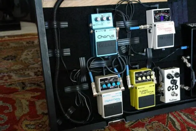

I used all of the loop side of the 15' X 2" roll on the floor of the pedalboard but have a bunch of the hook side left. On some of it I'm applying a cloth backing and cutting it into strips about 1/2" X 2-1/2" to lash down all the cables, to keep them from sticking up and / or moving around.

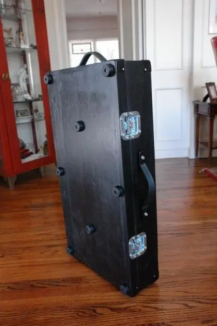

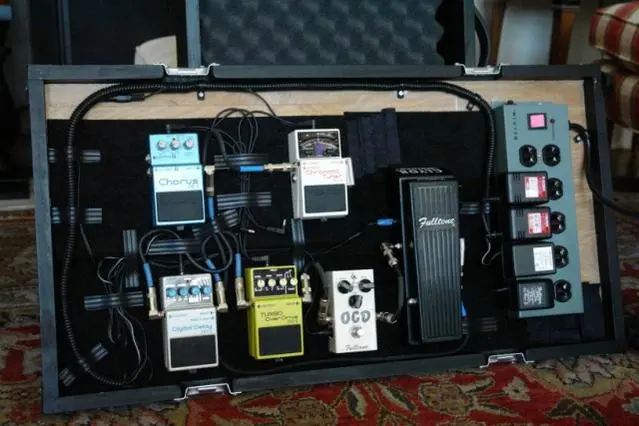

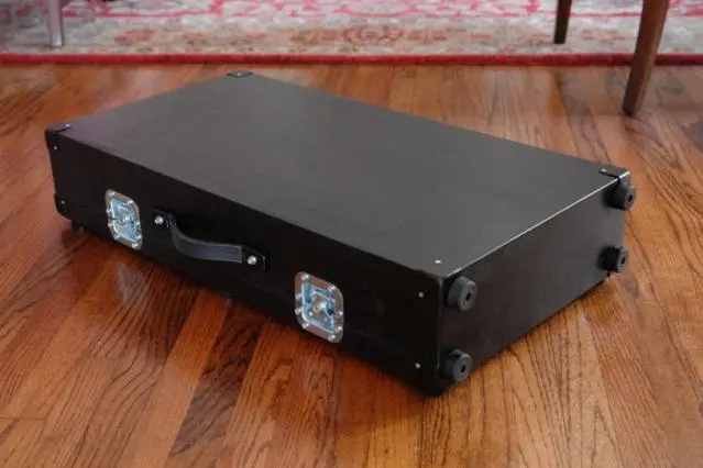

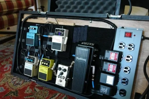

OK, Here It Is.....
Overall dimensions approx 33-1/2" X 17-1/2" X 8". Plenty of rubber feet.
...............and one more........
