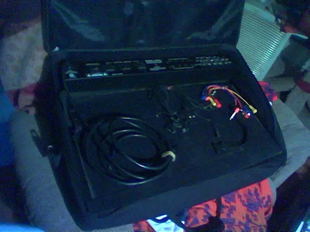

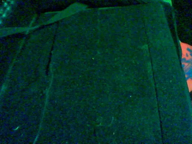

Ok, here's a pic of my Furman SPB-8, where the backing glue has slipped and the velco has slid to the top.
I suggest you use the velcro I pointed Zaphod to. That stuff has held up for years on everything I've put it to. I have two Tannoy M15 hanging from the ceiling in my workshop held with nothing but 3M 50mm velcro. They've been there for 7 years. They are a good deal heavier than your average foot pedal. I use it to hold work boards to the bed of my CNC, I use it keep racks of chisels on the wall and then move them to another part of the wall where I need them to hand. I use it for a bunch of other stuff. It will not slip or give in the application ZB is using it for. On the contrary if he is not careful and gets the pedals too close together he won't be able to get enough purchase on them to get then off.
What are we supposed to see in that pic by the way I can't make it out.

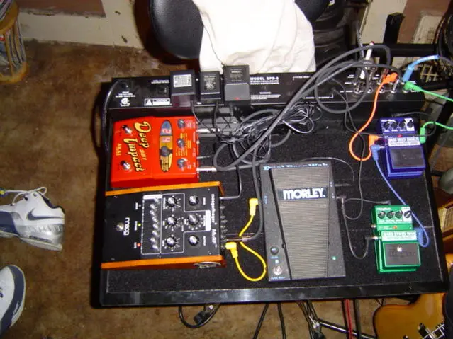

Its hard to get a good pic of black on black in black with a cell phone, But you can see that the surface of the velcro pad is wrinkled from sliding on the top pic. It was carrying a load. Its not the velcro that failed; it was the backing glue. Hot summer stored on its back and it was holding these...
