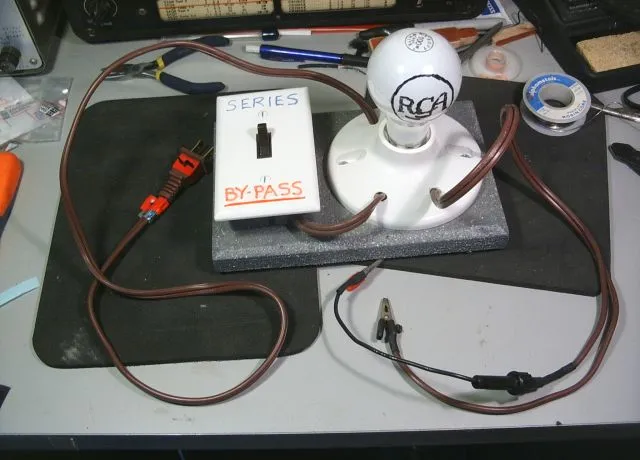

Startup- For intial startup I use a dim bulb tester. They're cheap, and very easy to build. What it does is put a light bulb in series with the primary voltage. If there is a short the bulb will burn brightly. If the bulb glows dimly the amp is probably safe to fire up. It's also a great tool for testing power transformers, and other things. I built mine with a switch that will by-pass the bulb, and added an inline fuse.
