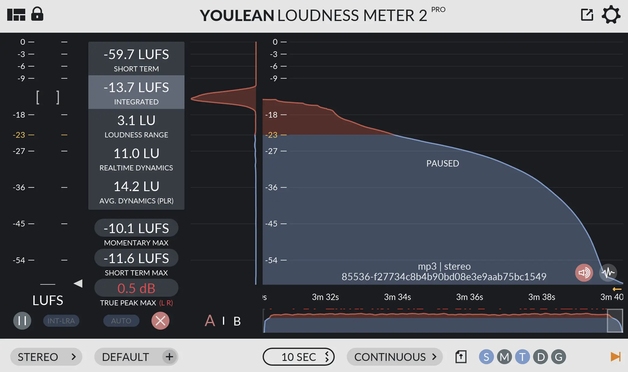

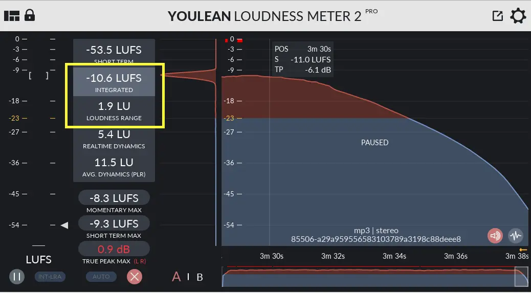

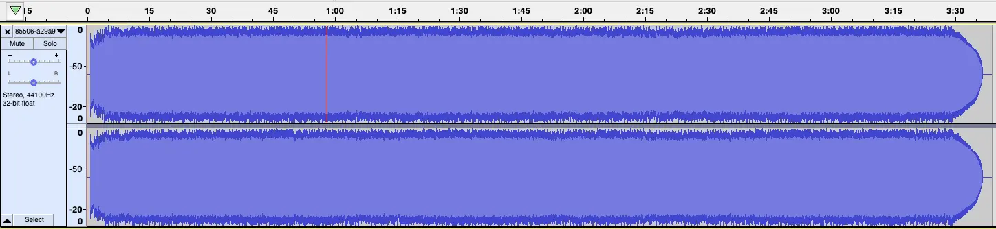

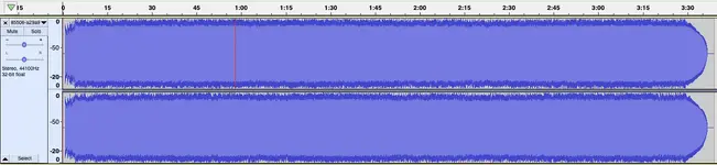

I just dropped it into the YouLean app and you have it pushed up high for the streaming targets, at least. take the limiter off and see where you are before you do anything. Normal targets are -17 to -14dB LUFS. You can see the loudness "range" is verging on "none" and the (admittedly, somewhat window-size skewed) view of the MP3 is approaching "sausage" in shape.

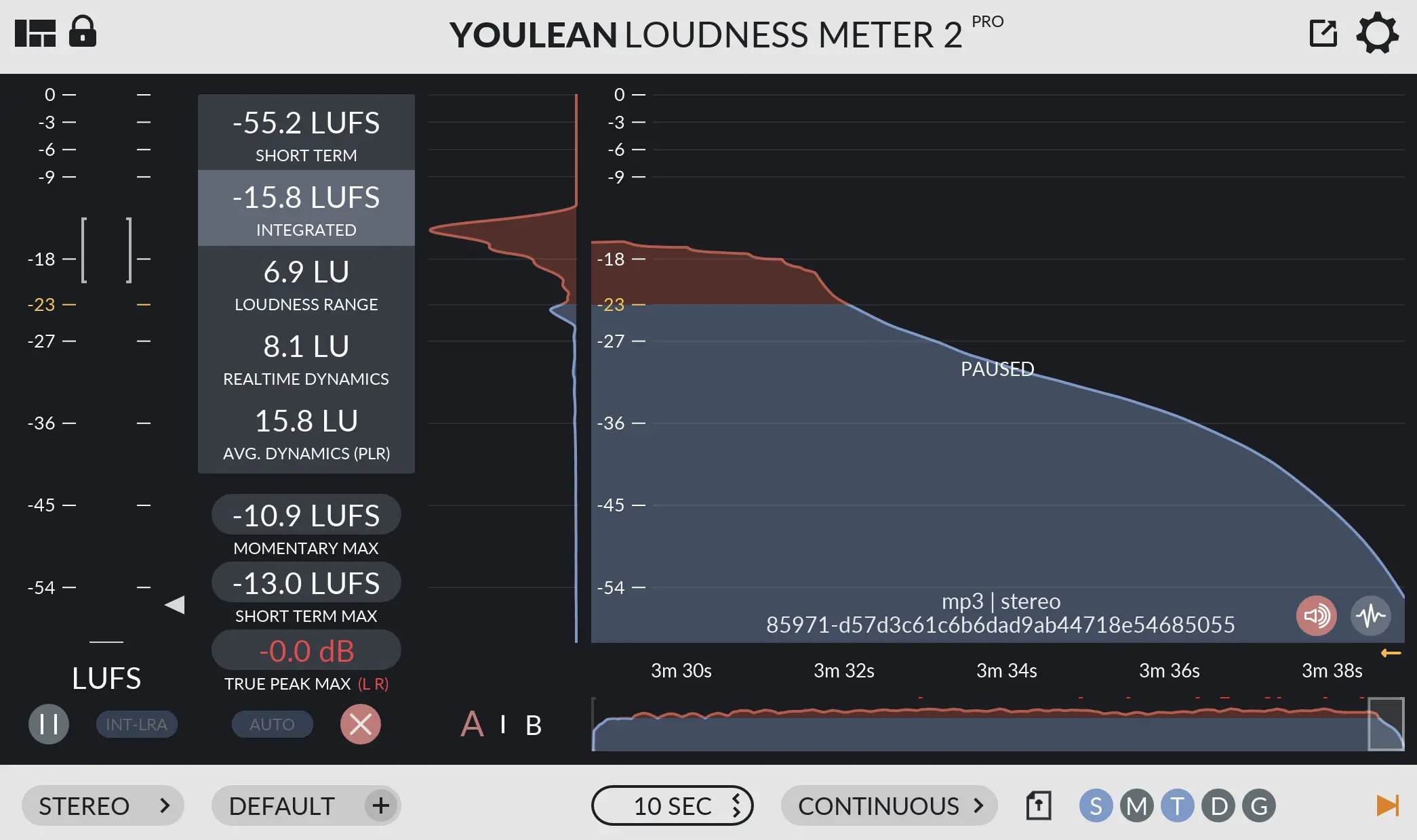

OK, I replaced the original file with a newer version. I tried to let this one breathe a little more. I also rolled off some low end to bring the bass down a bit.
As for the "sausage" shape of the waveform, hopefully this one is better... but I will say that the song itself lacks a bit in dynamics. Maybe that's how we covered it, or maybe it's the song itself. Again, comments are welcomed.
