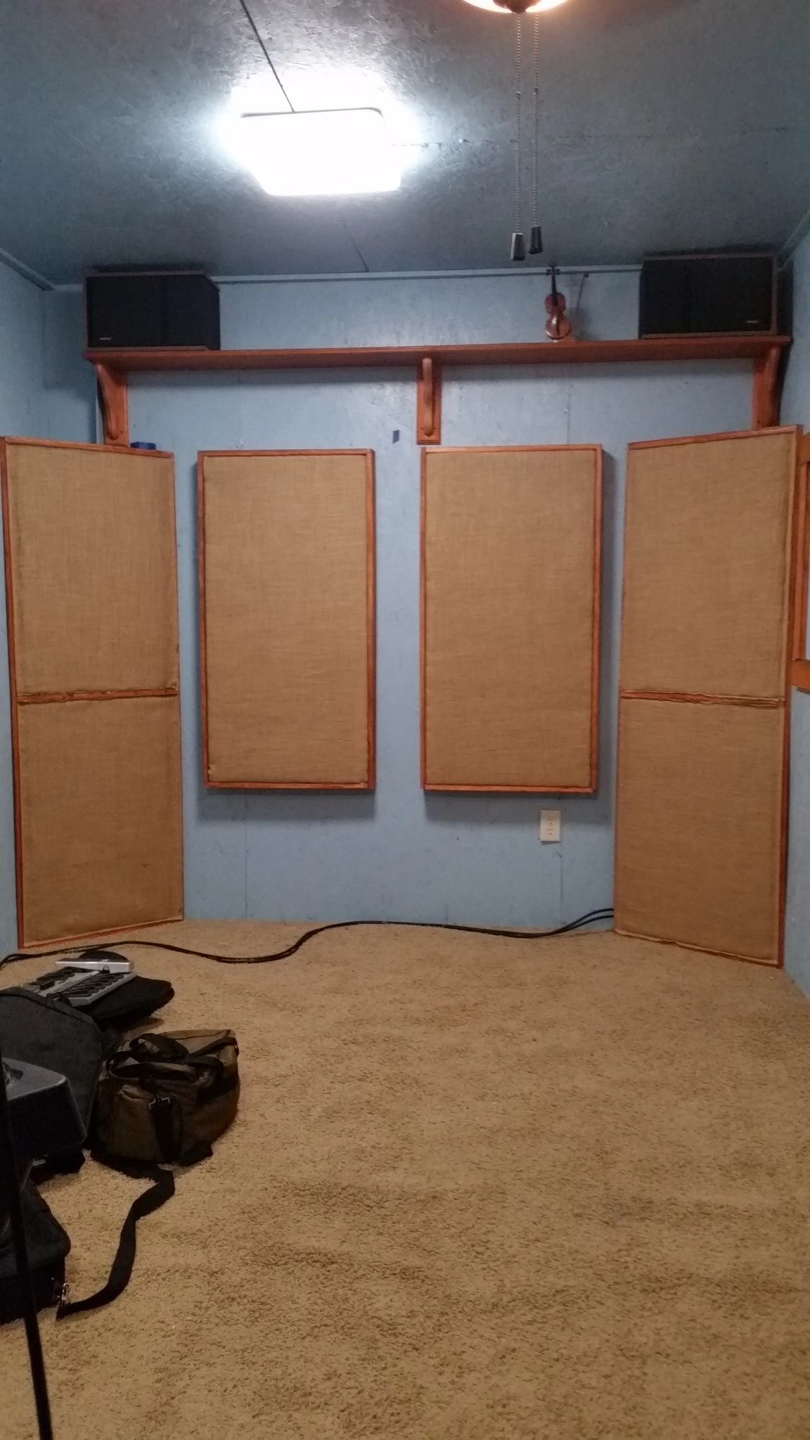

I am building my own traps, it comes to about 35 bucks per panel. using rockwool 60, 4 inches in the corners and 2 inches for the wall traps. :D
