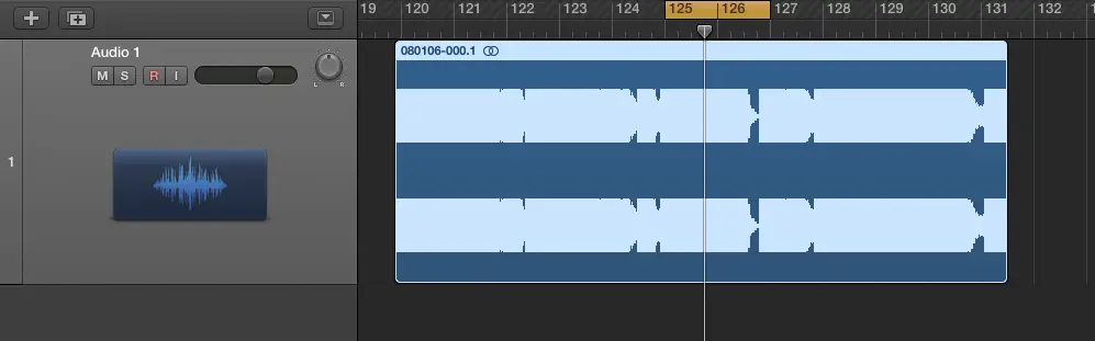

I have been recording music for 3 years and now recording through an Apollo 8 using various microphones no problems at all.
My problem has come along using a H4N and video mic pro to record a piano. If I use the pre amps in the h4n not much of a problem, I can work with that audio.
The problem arises when I set the video mic pro (supercardiod, 8inches away top of piano) to plus 20db and reduce gain on h4n. The audio never passes -6db but when piano part gets really busy it constantly stays at -6db and the recording is unusuable. The picture below shows the unuasable waveform.
I have learnt so much more complicated things when it comes to recording, yet this simple matter can't work out why.
Can someone please shed some light please?
Thank you

Just speculating, but with maybe just a whisker of experience here:
The H4N is expecting a mic level signal. You're giving it a line level signal. Take that 20dB boost off first and see if that fixes things.
If the signal is only getting to -6 and flatlining, you are distorting the mic.
The 20 dB boost on the mic is there to record quiet sounds, not to take the place of a mic preamp.
Take off the boost and turn up the mic preamp and everything will be fine.

If you're plugging into the XLR, then you won't be able to use the line level voltage. Maybe it will work how you want if you use a 1/4" plug. However, I'm willing to bet no matter how you connect and at whatever voltage level, you'll still be using the H4N's pre amps. In those types of interfaces, the XLR and 1/4" inputs use the same pre amps, just a matter of putting resistors in the line level side to lower the voltage. You're not bypassing anything.
Whatever picture you're referring to isn't posted.
What im saying is, with the 20 dB boost, you are clipping the internal circuitry of the mic. The mic can not handle being close to the piano with the boost on.
It doesn't matter what you plug the mic into, the distorted/clipped signal is coming out of the mic.

Thanks for this info. With the GH4 it works how I mentioned with the boost with no distortion. It's just with the H4N but can work around that by setting the H4N to even lower gain or only use it when source is really quiet. To be honest there is no need at all for me to put boost on for piano but when it happened I just wanted to know why.
It's definitely the internal circuit of mic clipping although not showing on H4N.
Your are 100% right, I just thought it would show on H4N.
Thank you.
There is no way for the h2n to know that the mic is clipping. If it could register clipping of things other than its own inputs, it would show clipping when you recorded a distorted guitar with it....
It only knows that it's converters are being clipped when it has a number of full scale samples in a row. So if the signal never reaches 0dbfs, it won't register clipping.
Thank you, I understand now.

Based on what you've described, I think a lot of the responses here are accurate, but based on the image you posted, it looks to me like there's some sort of signal being sent with the piano signal, like a strong buzz or something, that's causing the "block" waveform, but then there are little peaks here & there, which to me looks like the piano part peaking above whatever other signal is there. When you listen back to the track, is there a hum or buzz or something similar? If so, what's causing it?
You're looking it it wrong. The two light blue strips are the left and right channels.
Ah. I see it now. Funny how that happens sometimes. I totally saw the dark blue as the channels. Thanks for the correction!
That was the first thing I saw too... That's how I know what you were looking at.
