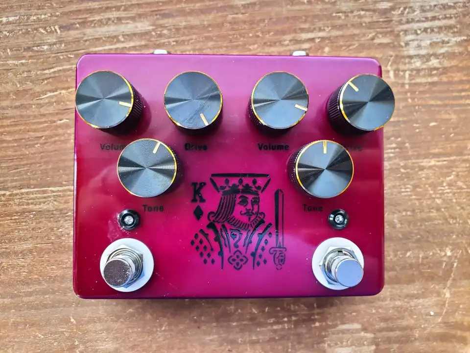

I used the pedalpcb.com paragon pcb.  I used what the real king of tone uses in the clipping section.  The only deviation that I am aware of with this build is the internal charge pump that runs the circuit at 18v instead of 9v so unlike the real king this pedal runs at 18v all the time and you can't run an adapter higher than 9v into it without torching it.
It's an amazing pedal and if it sounds anything like the real one I sort of understand the hype around this thing.
