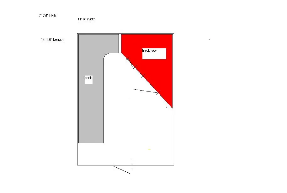

I have a shed off my home that I've decided to make my retreat, ah, I mean my recording shed. I just finished framing the inside (second wall), before I go any further I need to come up with a creative HVAC system. The only real source of power will be electricity (no gas). My question is does any one have any creative ideas for an HVAC system?
Dimensions: See .jpg

Onesnowrider - Judging from your name and location, I'm guessing you need heat and AC... With just electricity, electric baseboard heat is probably the cheapest and least intrusive option unless you want to get into solar siphons and heat storage... :)
For AC, a space that size could probably be cooled well with an in wall unit. Search in this forum for details of ducting one quietly.
Good Luck
Kevin.

longsoughtfor, thanks for the information. This was exactly what I was thinking. I guess I just needed some reassurance from others.
Generally speaking, for small studios you have two main options - one is to turn off the A/C when recording or doing critical mixes (final mix for example)
The other option is lots more time and money, and higher priced, slower moving A/C components. Even a standard window unit needs complex baffling unless you're so far away from air routes, neighbors, crickets, dogs, etc that you could just open the door.
Since this doesn't sound like your situation, one of the free-standing, no-hole-in-the-wall units may be your best bet. Just cool things down to a slight shiver, turn it off, record any acoustic parts, stop when it gets too warm and run the AC some more, repeat as necessary.
Saves having to become an acoustic designer just to keep from sweating.
The baseboard heat, while pathetically inefficient, is also the quietest so could be on in the winter whether you're recording or not... Steve
