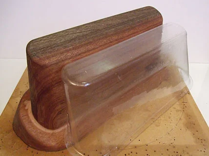

Metal covers although not impossible would be difficult, and very expensive. I've looked into vacuum forming my own plastic covers in the past. This is by far the easiest, and least expensive solution to DIY pickup covers. Once again this thread has piqued my interest in trying something new. :)
After exhaustive internet reasearch (google) I found some instructions for making a simple vacuum forming rig. Make a good, cheap, upgradeable sheet plastic vacuum former
I have most of the stuff I would need to make one sitting around. I think I'm going to give this a try. (check out the picture)

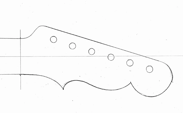

Meanwhile, here is a headstock drawing that can be used as a starting point for discussion.
Either you have great taste, or you copied the headstock on the guitar I'm building.:)

Nice, I like that.
BOTH!!!!!!:)
I drew it independently but I noticed how similar they were. I didn't mind a bit. I hope you didn't.
That looks really interesting. I have a lot of experience on post forming and vacuum pressing with timber and plastics from my days at BA and Rolls Royce. Definitely do a walk through with pics if you test it out. If you do lets try and get a few covers made for this. They wouldn't cost much to ship and I'll cover costs.

Very little if anything hasn't been done before. The sketch I posted is just a retake on the early telecaster...
Nice, I like that.
Good I'm going to use it. Will be cutting the outline today hopefully and get some more pics up. I thicknessed and veneered the headstock last night and will be roughing out the neck later today if I get a bunch of repairs done first. Pics to follow.
I wonder if you could find some ivoroid or MOTS to mold. The right color MOTS would kick ass.
I don't know if you could get postforming laminate in MOP but you could certainly get a resin cast cover that would look pretty much the same. I have done some parts before with a degree of success.

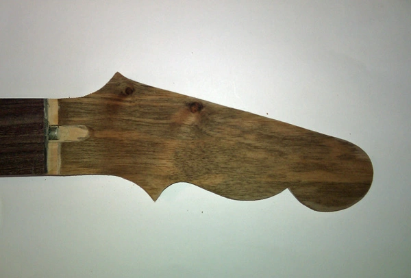

Pics of the headstock taking shape as promised.

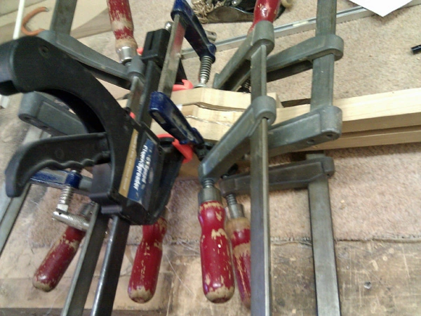

First off I thicknessed the headstock and neck blank to the final thickness minus the veneer thickness using the router sled as pictured before so no need for a pic of that. Cut the two veneer pieces, one front and one back of the headstock. It's always a good idea to veneer the reverse of anything veneered with wood to stop it pulling out of shape in future. Clamped up the veneers with two cauls and lots of clamp pressure.
Once it's dried simply mark the outline and cut on a bandsaw. I will make a router template of the final shape if I decide I want to use this outline again.
Here is the outline. Hope you'all like it cos we are stuck with it now. I leave the tuner holes until after the final sanding and finishing has been done to help get a true flat finish with no "dubbing" of the hole edges. The sharp eyed will notice I left a point on the top edge. Should this stay or should we go back to the original round edge?
The veneers are cut from the offcuts of the top so all should have a nice colour match..

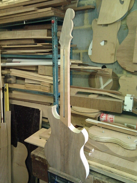

Finally the guitar is taking shape.
I shall radius the fingerboard and do a very rough neck profile next at the same time as working out the chambres and pickup routes so if we can decide on final pickup design and spec today it would be good...

I prefer not to have the point on the topside of the headstock. JMHO
