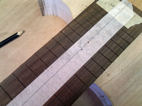

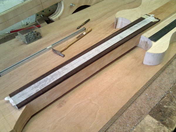

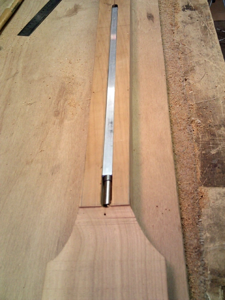

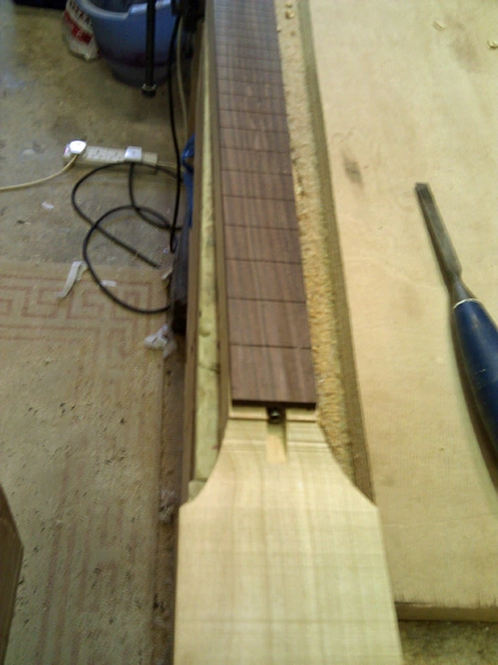

While deliberating on the top and cavity locations it's time to route the truss rod slot and taper the fingerboard.

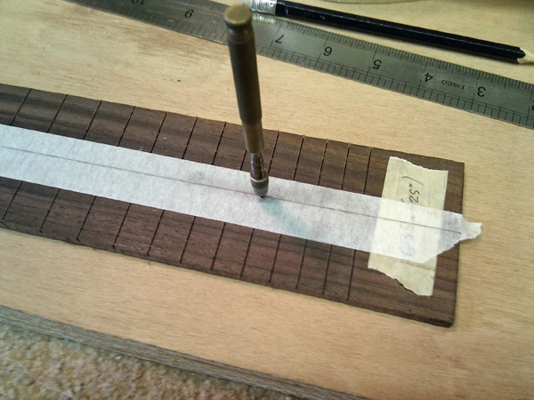

First thing is to line up the fingerboard on the neck blank and put a couple of pinholes through the fret slot so it can go back in EXACTLY the same position every time. This will also help stop the fingerboard slipping when time comes to glue it onto the neck blank.
Once the fingerboard is in the right place small veneer pins are tapped through the pin holes to locate the f/board.
The pin holes allow me to mark and cut the taper off of the neck blank or the mold since both have the same taper.

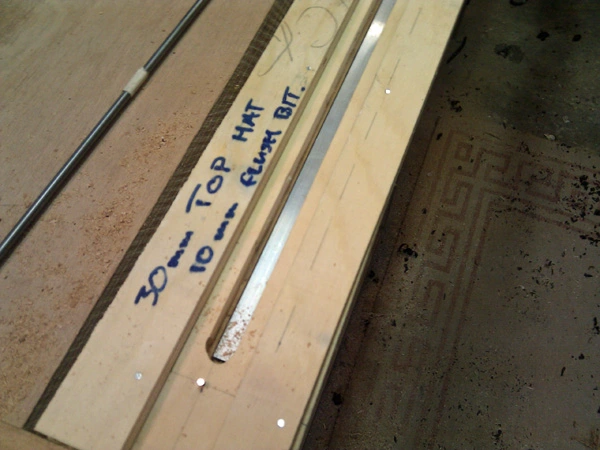

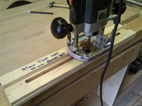

Once the taper is cut the finger board can be set aside and the truss rod channel cut..
Reach for one of many truss rod jigs.
This one cuts a 10mm channel for a standard u section rod.
The sharp eyed amongst you will notice the pin locations on the neck have been routed away. These will be replaced when the wooden fillet is over the truss rod and before the f/b is glued.

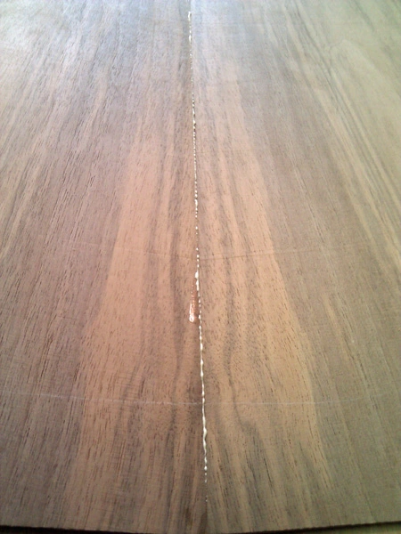

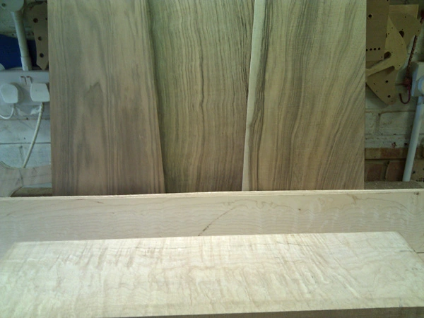

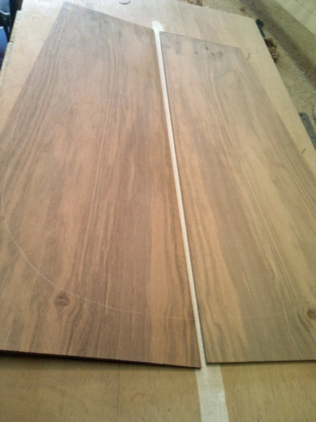

Going to pick out a fairly average piece of English Walnut for the top and joint it up incase we go with the all over top approach. If not I can still rip it apart for the wings.
A quick play on the shooting board and it's ready for jointing.
Jointed up and wedged closed on a board. A little weight to stop it cupping under pressure.

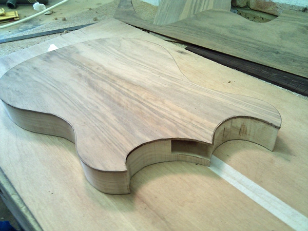

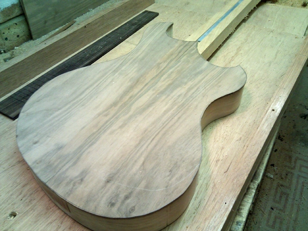

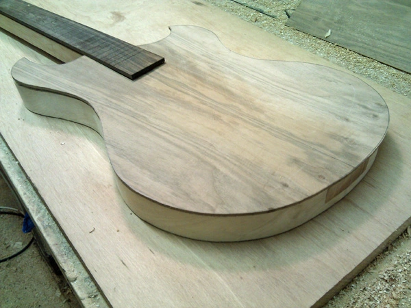

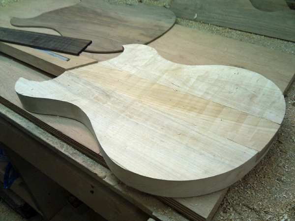

Top covering the neck through it is. To do that I need to remove the thickness of the top from the body and from the neck block so the top butts up to the neck block and the f/b lays flat across both.

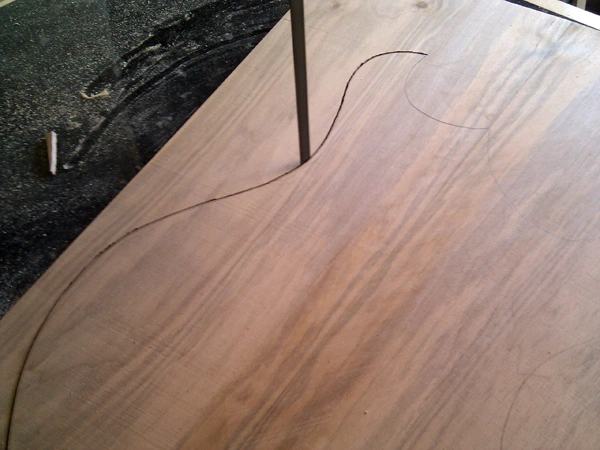

First cut the top to rough outline.
Offering it up to the body shows the step in the body and neck block that needs be cut.

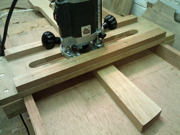

Cutting a step like that needs the router sled. First I'll take the neck block down and then the body blank.
The router sled allows a plunge router to travel across the work piece to thickness accurately when a surface planer cannot be used. Once the router is set to the correct depth it will cut whatever you clamp under it to the same thickness. In this case the neck blank and body leaving the neck itself flush with the top of the body.
The cap now fits flush with the top of the neck block and the fingerboard lays flat on top.

Cutting a step like that needs the router sled.....
...The router sled allows a plunge router to travel across the work piece to thickness accurately when a surface planer cannot be used. Once the router is set to the correct depth it will cut whatever you clamp under it to the same thickness.
Nice tool! I'll be making one of those. I can think of a few uses for which it would be very handy. When I built the Jr. I put a taper to the body of about 1/4 inch. It would work great for that.
