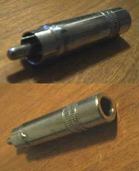

A cable with 1/4' plug on one end, and RCA plug on the other (or if it's like a guitar cable, get a 1/4" to RCA adapter for one end.)
Here's what one type of adapter looks like.
