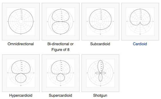

Once I pulled the headphones, it was pretty easy to distinguish the background levels. The Shures were all pretty quiet, followed by the RE320. I don't know that its as much a difference in the "sensitivity" as the difference in polar pattern efficiency which would be a design element. Surprisingly, if you look at the pattern of the Beta 58 vs the SM58 or SM86, the SM actually has better rearward rejection, where the Beta has a node to the back with a narrower soundfield. This is characteristic of hyper and supercardioid mics. You should take this into account when you position the mic relative to the noise source.

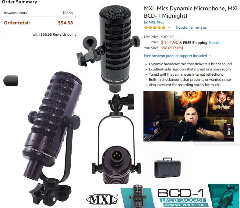

Stumbled on this MXL BCD-1 as cheap as $111 with case, foam...seems to be very serious room rejection.
Obviously copying the RE20 and SM7b family types, but a cheaper MXL version.
this video that does a very good comparison. Check it out at 2:23.
MXL BCD1 - Bing video
Again maybe the OP has a bad mic noise issue? but if it is room noise, something like this BCD1 might work.
I grabbed one with a discount I had, off the $111. ..$54..
I've had the SM7b so I predict the BCD1 will have similar needs.
ADD: price on Amazon is $95 today...so I paid $6 more? they wouldn't price match. Midnight Limited color (probably not selling well)
