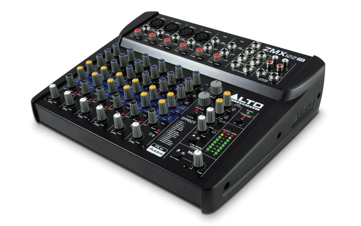

When you say "four channel USB audio interface" do you mean something like a USB audio mixer such as this one? This is all new territory for me when it comes to mixers.

I'm not sure about those, but many small USB equipped mixers only send stereo signal to the computer. An entry level option would be something like this:

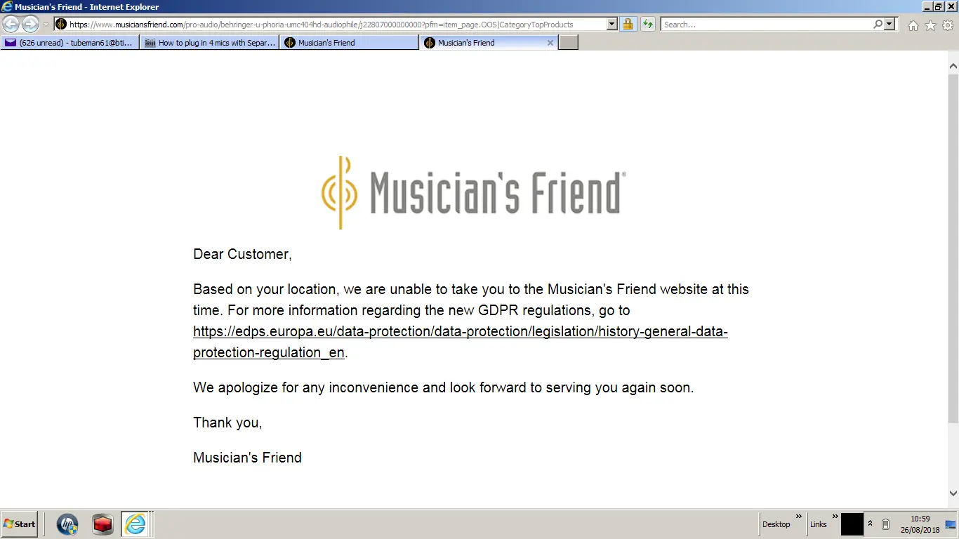

First off, can anyone help me/tell me WTF is going on ref the attached?

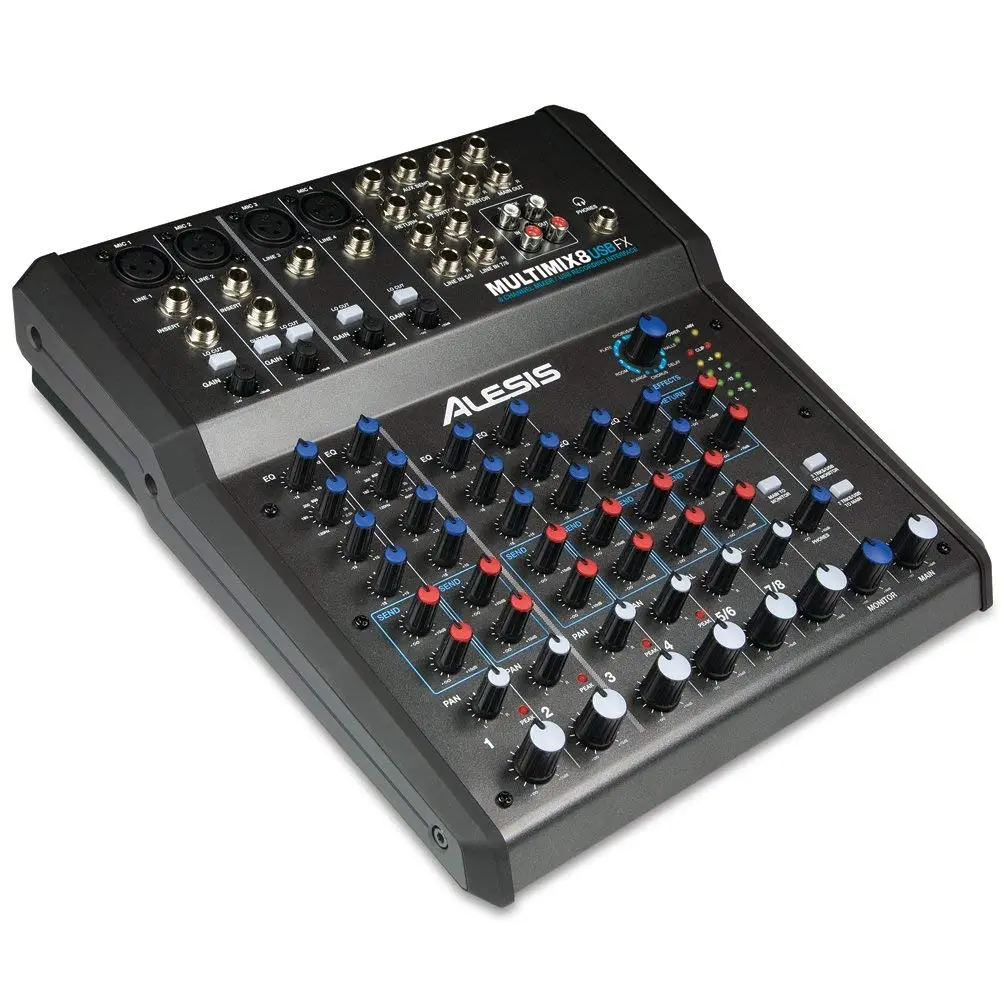

Yes, most of those mixers only produce a stereo track and many are crap sound with it. There is (was?) the Alesis Multimix that was multi-track but I seem to remember peeps had all sorts of driver issues with them?
You must be in the European Union, Dave.
This is the result of GDPR - new data protection rules with which websites serving the EU must comply or face huge fines.
Basically, the websites have to guarantee not to keep data on you to use in ways they don't tell you about. If they try that, they also face huge fines.
Most sites across the world saw this as easy to comply with and did the necessary work. Lazy or incompetent or paranoid (mainly USA) websites chose not to and therefore stoped serving EU IP addressed computers.
Oh! Ok, I am obliged. Hardly ever went there anyway so stuff'em!
Nor me. Whenevr I did I found "this item doesn't ship outside USA" most of the time, which is fair enough.
