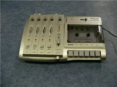

What do you think of a TASCAM MF-P01 Recording Bundle? Is the crappiness of the mic not worth it? I'm really looking for a cost effective solution.
Would a DMP3 be suitable as an external pre?
That unit wouldn't be my first choice. Yes, it's incredibly cheap.
But you can only record one track at a time.
It has no noise reduction.
It runs at regular speed, not double speed like any of the better ones.
It has no eq.
The lack of noise reduction and double tape speed are definite deal breakers. The sound will be pretty horrid, and not near representative of the quality you can get if you spring for just a little more. A little patience will serve you well and you'll have a peice that you'll keep around a long time.

I'd go for the 488 or 488mkII, of the units mentioned so far,...
with something like the 424mkII or 414mkII as second choice,... and forget the rest.
The Tascam MF-P01 and Fostex X-12 are so low-end and lacking in features & capabilities, that they relegate themselves to being only "scratchpad" recorders, and limited ones at that. The MF-P01 and X-12 don't have what it takes to make "serious" productions in home recording. However, it's a great first step or intro- recorder to the complete novice or 8-year old home rec'er, but anyone with any aspirations or talent would quickly out-grow those recorders,... like in a day or two.:eek::eek:;)
The high end Tascam Portastudios are worlds apart from the low end units.:eek:;)
