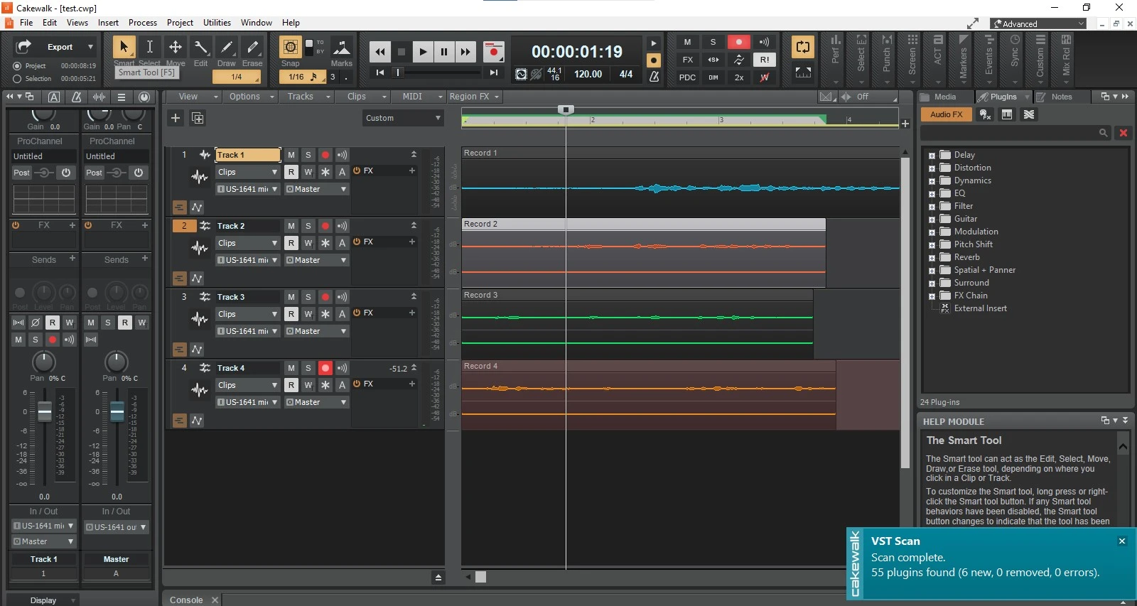

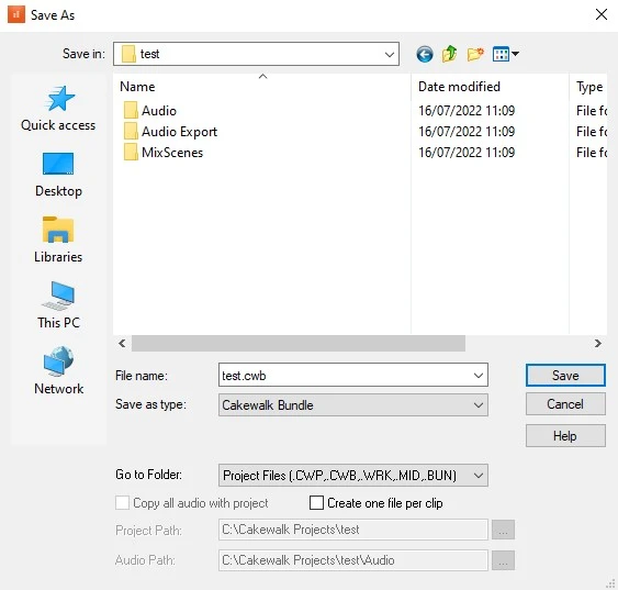

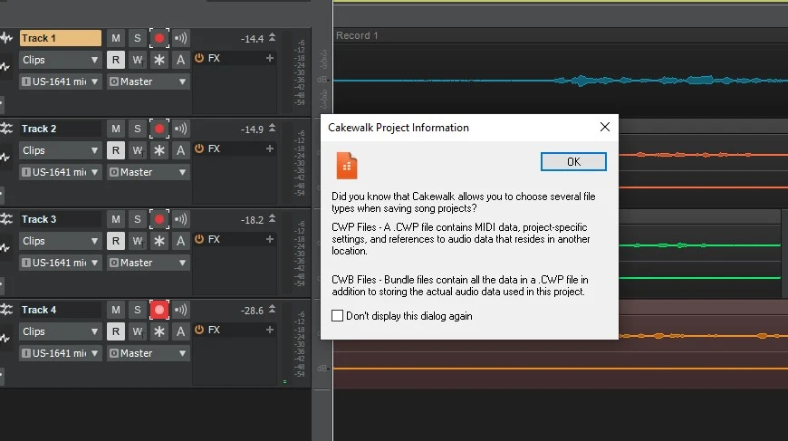

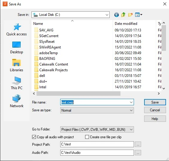

Cakewalk is free, and rather nice. You record your tracks and by default it records them as .wav files. These are stored in the audio folder inside the main Cakewalk folder created on your C: drive. projects are stored either as .cwa files - which have the data, plus links to the audio in the project (stored in that audio folder) or as a complete package of eveything saved as a .cwb file. Mixdown defaults to .wav, but here of course you can change that to your .mp3 format for distribution. By default cakewalk uses non-compressed files as they all do. If you do not want to lose things, in your cakewalk folder will be the project folder - in my case 'test' simply copy and paste this to your removable drive - BUT - it will be quite big of course.
There is no problem with backups and it recorded my test tracks as track 1, track 2 etc. It also found my VST folders and is happily playing some samples, synths and drums on my cubase install! For newcomers it's rather nice and free. I guess you can upgrade and pay for things maybe, but it seems pretty good so far.

If I save in my pendrive using image 2 , can have a back up, you said?
