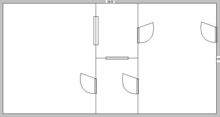

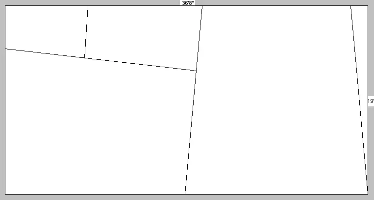

Here's a couple of really quick suggestions. Choose which one you like, or suggest another, and I'll draw it up in detail. Square rooms are bad. Rectangular rooms are better, but still not great. If you want rectangular rooms, then you can sort some the problems with absorption/diffusion. I'd suggest splayed walls though.

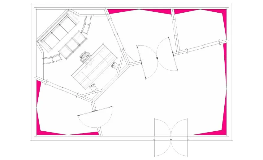

sorry to ask a question but
whats the reason for the triangle shapes arround the exteria of the room in each of the rooms ?
the ones in the picture they are on the walls arround the edge of the rooms (not in the control room but the other 3
the coloured sections

I guess:
in a square or rectangle, sound waves can bounce back and forth, standing waves can occur, the room will respond particularly to certain frequencies dependant on its length and width. But with irregular angled walls, reflections can dissipate. Like the stealth fighter plane is funny angles to reflect radar differently......
I guess!

I guess:
I guess!
Excactly right :D

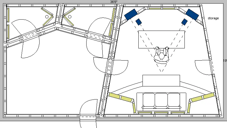

Anyway, here is my suggestion.

You don't have to pimp out crap bands. You can choose who you manage. Anyway, I think your idea is quite a good idea. That along with mixing and mastering(especially stuff recorded elsewhere) would be a good business.
I think that's to break up the straight walls.
you need space for trapping. and broadband needs variations. by building rectangular walls, you can easily calculate the expected modes and MSM characteristics, and then build out treatments on angles to break up the space and get that 1-2.5' (0.3m-0.75m) deep traps and slats, diffusors, etc that you might normally penetrate isolation walls with...
also, don't use the same room for mix and mastering. they're two different functions of the process and whatever defects exist in one or the other are masked by using a single room and same equipment...
