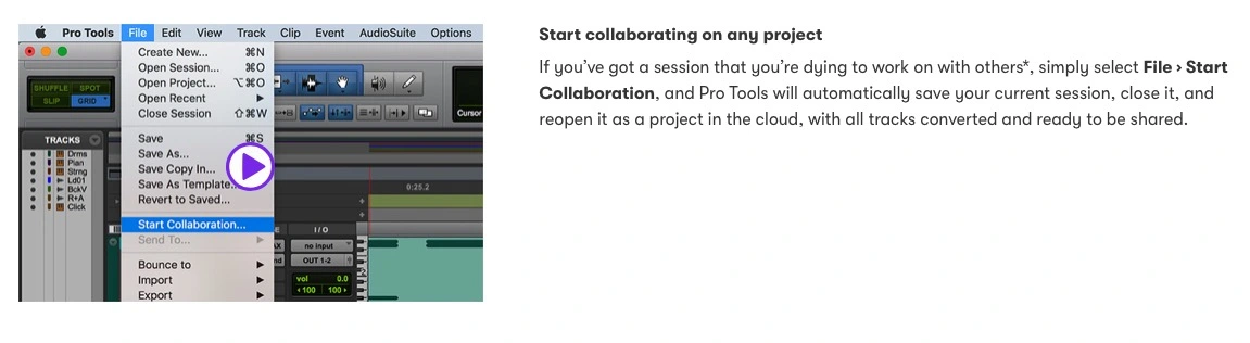

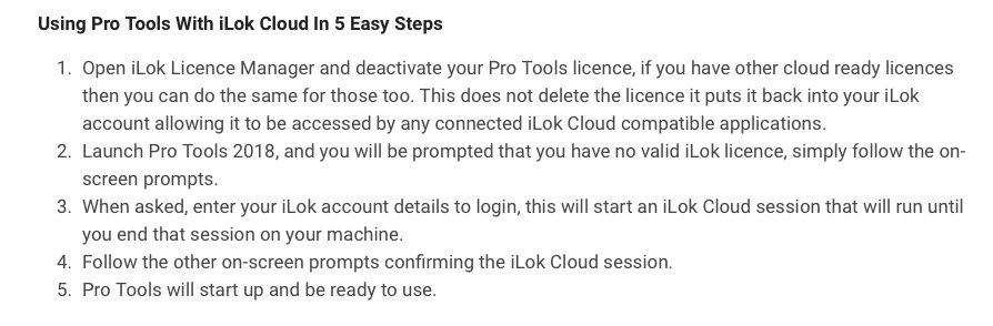

Don't Avid have some system for exactly this scenario? I'm still on older versions but as far as I know newer versions have cloud options for sessions and licenses.
Just checked - Yes, they offer cloud services for both.
So basically go to file>Start collaboration, save + quit.
Then in ilok manager deactivate your PT license.
From there on it looks like you just sign in using ilok credentials when PT (anywhere) says "where's the license at?"
