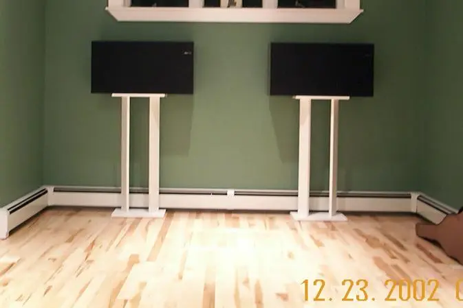

Here are my DIY stands - simple white MDF and drywall screws. they have chair pads on the bottom to keep from scratching the floor. predrill/countersink the holes in the MDF.
DAN
BTW, I've added some gear to the place since this photo ;-)
