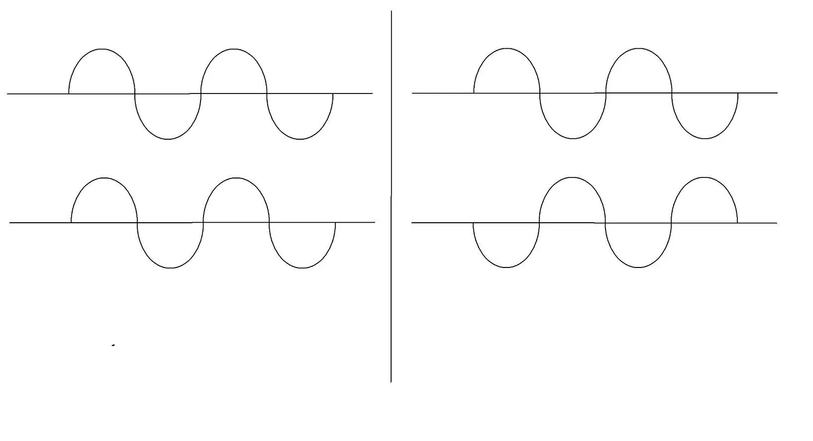

thats one of the dumbest things Iv ever heard....you dont need to invert the phase unless they are out of phase.....dont do it by routine....sometimes I have to invert phase....but more often I dont....
I hope my attatchment was added.....the left side of the line shows a wave in phase....if you zoom into your tracks...and they look like this...dont reverse the phase....the right side of the line is out of phase....correct it by reversing the phase or in some cases just slide the track left or right just a bit to line it up....

I think that lots and lots of people do this routinely. It's not dumb advice at all. It probably became routine way before people had computers to zoom in on, and used their ears to decide what sounded best.
I dont have a problem with someone saying "dont forget to reverse the phase on one and see if it sounds better!"
but not "and dont forget to reverse the phase on one or it will cancel out!"
big differance there man....

Think about this for a second. As you strike a drum, you create a pressure wave. The force starts downward and then cycles up as the heads vibrate. As you strike the top head, the wave presses downward on the bottom head and they move together. You have a mic pointing downward on the top head and one pointing up on the bottom head. One mic is catching the initial pressure wave moving away from the diaphragm, the other is catching the wave coming towards the diaphragm. If the mics have the polarity of the diaphragm in the same direction, they will be out of phase with each other in respect to the wave. So general practice is to reverse the phase of the bottom mic, although it doesn't always apply. It's sort of standard operating procedure unless there are other considerations.

For general phase considerations, yes, that's appropriate. However we're talking about miking a snare with top and bottom mics. If the diaphragms are pointed towards each other on opposite sides of the snare, you WILL 100% need to reverse the polarity on one of them to avoid cancellation. Sound pressure doesn't change the way it works every now and then to screw with us, as much as we probably think that. While I don't recommend blindly doing things without thinking about what you're doing, saying that they may not cancel just defies physics, for reasons PhilGood explained.
Unless that's the sound you're going for. :confused:

Folks, what ThaJeremy said about phase relationships between top and bottom mic makes a ton of sense.
It seems to me that the people arguing with his point would have to imagine that the top and bottom mics are placed in exactly the same spot... like x/y mics placed facing eachother directly. But they are actually 6,7,8 inches apart. The distance between them should make it a little more complicated than an automatic inversion on every frequency, right? The waveforms might well be out of phase in some other way than exactly inverted.
Imagine water waves started at eachother-- if their phases line up, there will be big harmonic interference as their peaks combine... but if the point of generation varies, the degree of interference (ie their phase relationship) will change.
It seems wise to invert as standard practice to check the sound, and if you're just quickly throwing a mix together. But why not look at your wave forms to truly see how the phase is working with yout setup and adjust accordingly?
Please convince me otherwise, as I do not actually have much expericence using more than one mic on the snare.
