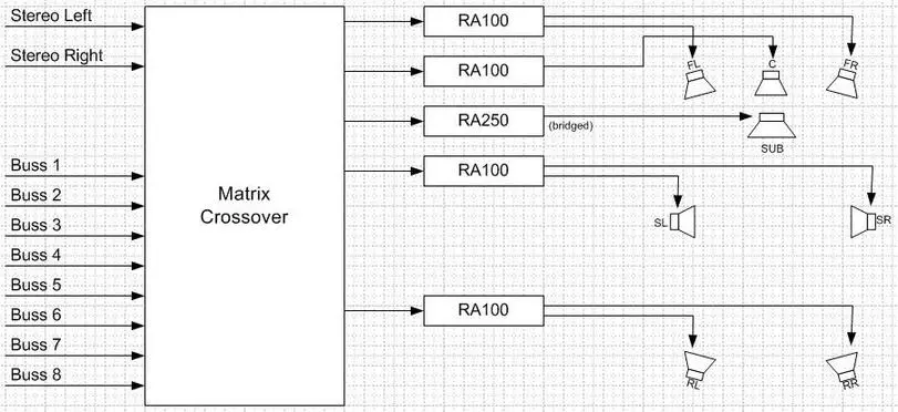

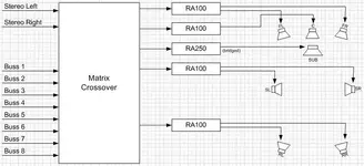

Here is how I have my studio monitors wired. Mostly these days I do stereo work however when I built my studio 4-5 years ago I anticipated doing a lot of surround work, so I wired the studio for stereo and surround (5.1 and 7.1).
In stereo mode only the front left and front right monitors are getting a signal, and if I select it the subwoofer will also. In the "matrix crossover" are several filters so the sub is fed 20-45 hz whether it gets the sum of stereo left and right (or) fed by it's own buss in surround mode.
All the other monitors have a filter as well, blocking less than 40hz, and that's bypassable across all channels simultaniously.
The "matrix crossover" is just a bunch of op-amps, an +/- 16V power supply, basic filters with a very sharp rolloff, and some digital chips to switch between the various hard-wired modes.
Mixing in surround is fine, but to encode it I have to take the 6 or 8 output wav files and process them with a piece of software - an encoder - so they comply to whatever standard/format I am required to mix in - THX, Dolby, etc.
I haven't purchased any encoder software because I haven't had any paying jobs that required surround. But, the capability is there even though I never really use it at this point.

Anyway, monitor/amp diagram:
