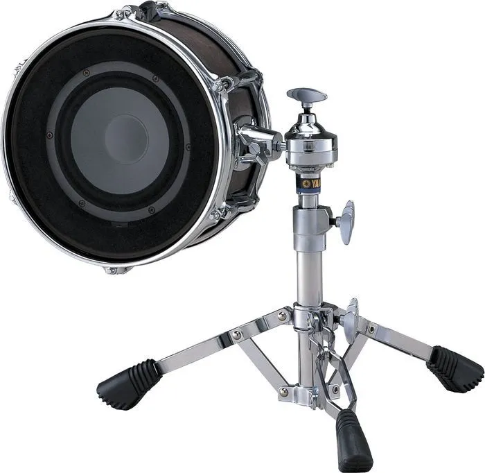

rweiss said:
When I can get hold of a decent bass amp, I'm going to reverse the polarity and use it to pickup the low end of the kick by placing it in front of it and recording through it (search the forums for this technique).
-Ryan
You might try using the Yamaha Subkick! It's awesome for a Kick, or a Bass Cabinet! I usually use two myself, one of the kick (along with a 'regular' kick mic), and one on the Bassist's cabinet!
