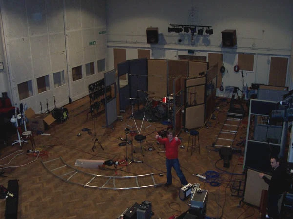

Use one big tracking room for sure. If the band want to record a live demo then thats your best option. Dont block everyone off into little rooms. Sure there might be spill if you dont control it, that will add to the character. Just track the instruments then do the vocals after. You could even just build a vocal booth. Personally i would use a load of gobos.

A Gobo or "go between" is an acoustic panel that can be moved around along with others to form Reflective/absorbant areas in the recording environment. You usually see them in recording studios.
Heres some in Abbey Road.
lol, must be nice to have a concert hall to record in. It seems like a very useful panel to use in my situation.
