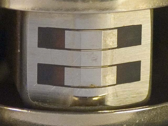

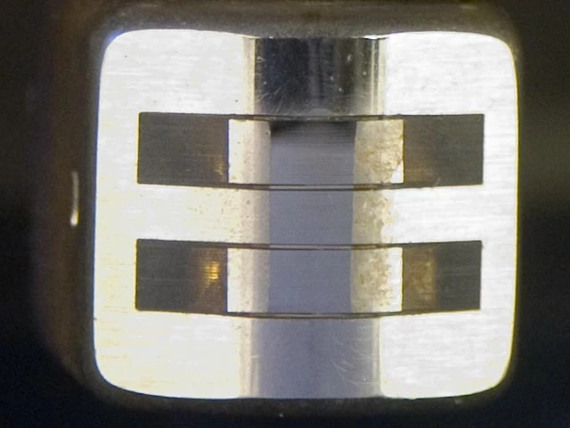

How do these heads look to you?
  • Thread starter Thread starter 7x7
7
7x7
I don't know how worn I should consider these, how much life would be in them, in percentage? To me they look like they're in a pretty bad shape but I'd love to hear more educated opinions... (the first is the play head, the 2nd the record head).

Looke like they need a relap & a good clean?
I'm sure the real experts on here will be along in a while!!!!!!!
Tangent
They look good in general. It would be worth measuring how much wear before starting a relap.
The upper head looks to have been off in tangent. That is to say that the wear is more on one side than the other.
The recording gap is NOT visible so there is some life left in these heads.
I wonder what the "blemish" is at the bottom of the lower head. Is this dirt/dust or the head gap starting to show?
You could use a caliper to measure the depth of wear. Somewhere in this BBS I posted the typical allowed wear for a bunch of Mfg heads. I don't remember the numbers off hand.
If you measured 1 mil of wear on a head that has 2 mil of gap depth then you would be abouut 50% worn. After a relap you would have perhaps 40 or 45% life left.
Regards - Ethan

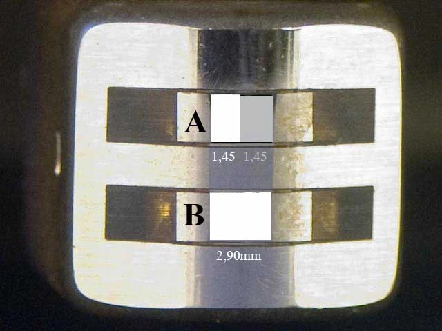

Right, now I think I understand! I was also looking at the black parts that look worn, but I should be focussing on the 'flat spot'?
The 'Relapping Heads' topic and the Nortronics manual are pretty clear, I sure will give it a try. I do hope my hands aren't too shaky... Perhaps it's no rocket science but it does look like surgery ;)
I'll be looking at the blemish part today, my girlfriend took her magnifying glass to work :D (she's a nurse, no worries there ;))
As for the numbers, what do you mean with the 'crown' of the head? Since heads are symmetric, I believe you mean the center? Should I be looking at A or at B?
These numbers look pretty bad (1,45mm = 57mils, not by far in the range of the numbers you mentioned)...

almost
A and B are in the Z axis. That is to say they represent the depth of the flat spot. The center of the flat spot is B. It is how deep the tape has worn the head away. A is the side of the worn spot. (So it comes out of your screen to you)
Here is another crude drawing looking down on the head from the side with the tape running across the head from behind the drawing straight out at you.
..................+ A
.............+ B Track 1
.............+ B Track 2
Measure from A to B to find the worn depth.
When heads are new A and B are (more or less depending on the head) at the same level (left to right in this drawing).

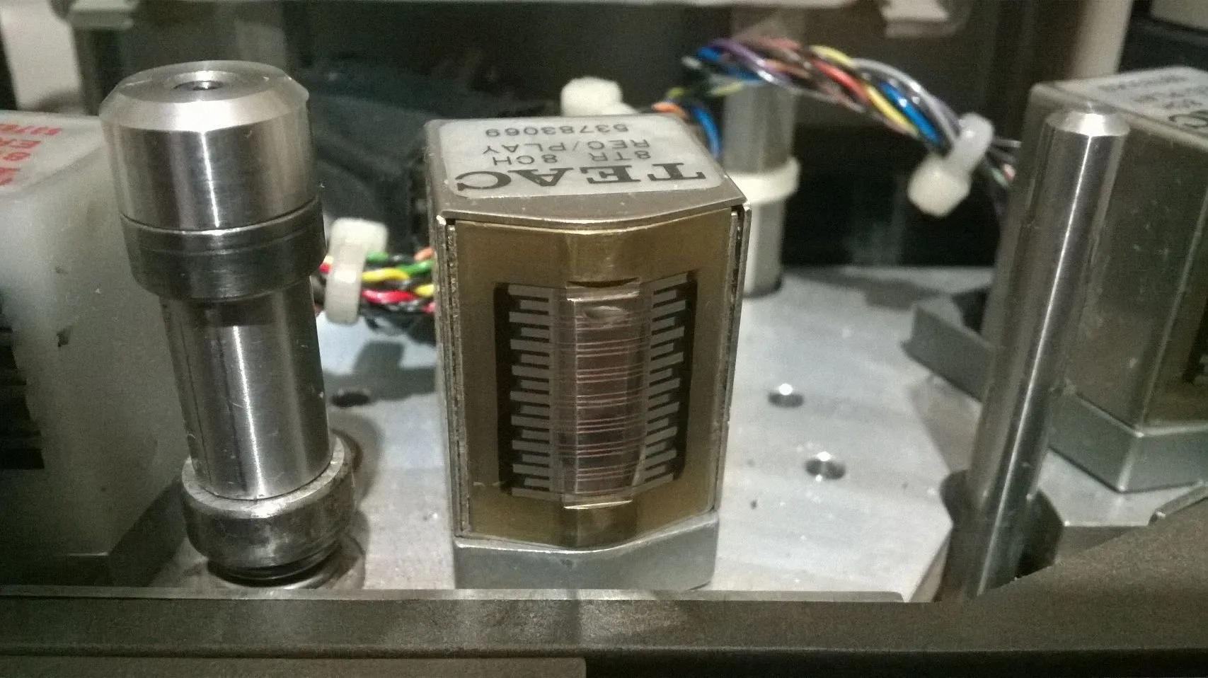

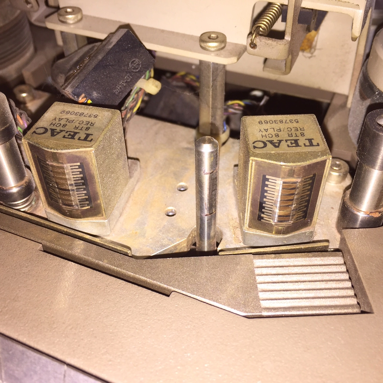

Head wear
Hello, I realize this is a very old thread but I need help?? This is my first post on this wonderful forum, I've always been a reader but seems not a writer yet!

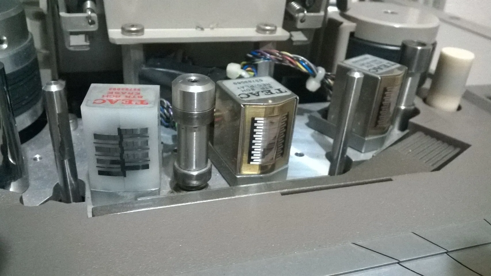

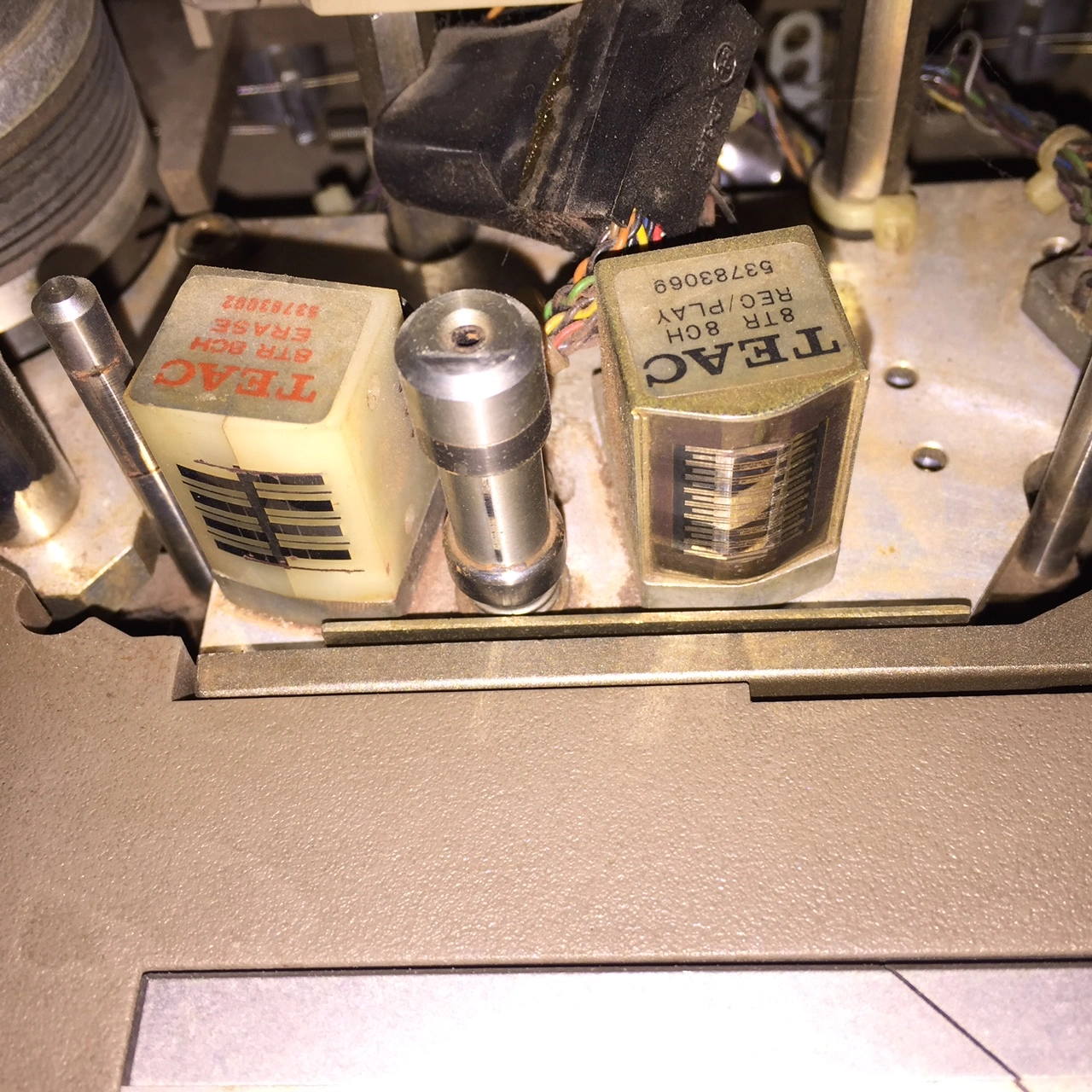

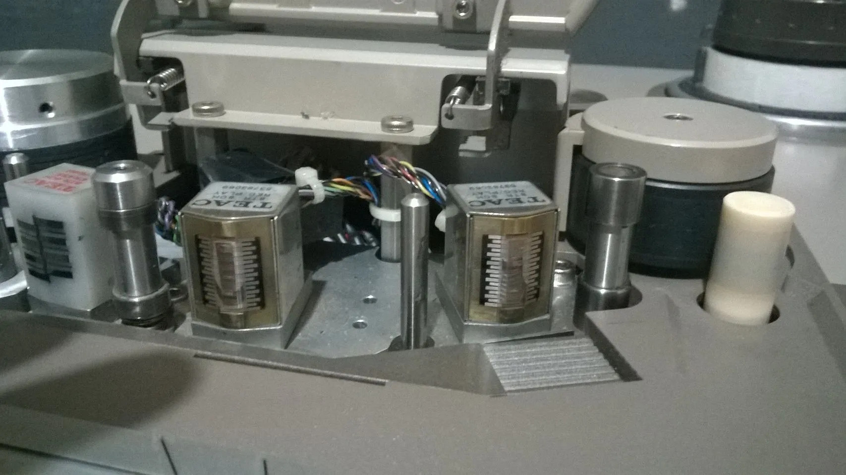

I got offered two used TASCAM ATR 60-80 for a great price here in Spain. The thing is I can't inspect the recorders as they are 6 hours away from where I live, so I got both sellers to take pictures of the heads.
I need help as to how this heads look, they seem worn to me but more exeprienced eye could probably help me out. I've already asked them to clean the heads and take better pictures. But maybe someone can see rght away if they are worth it.
They are offering them at very affordable prices, 300 euros and 500 euros respectively. So maybe I could relap the heads and have good machine for some time.
I've attached pictures of both machine's heads. Any help would be truly appreciated.
thanks in advance to any help and cheers to everyone!

They are a bit flat, but not too bad IMHO. I think there's a fair bit of life in them yet.
Crucially, they don't seem to have any keystoning where the bottom is more worn than the top, something which seems to happen quite often on TASCAM decks.
