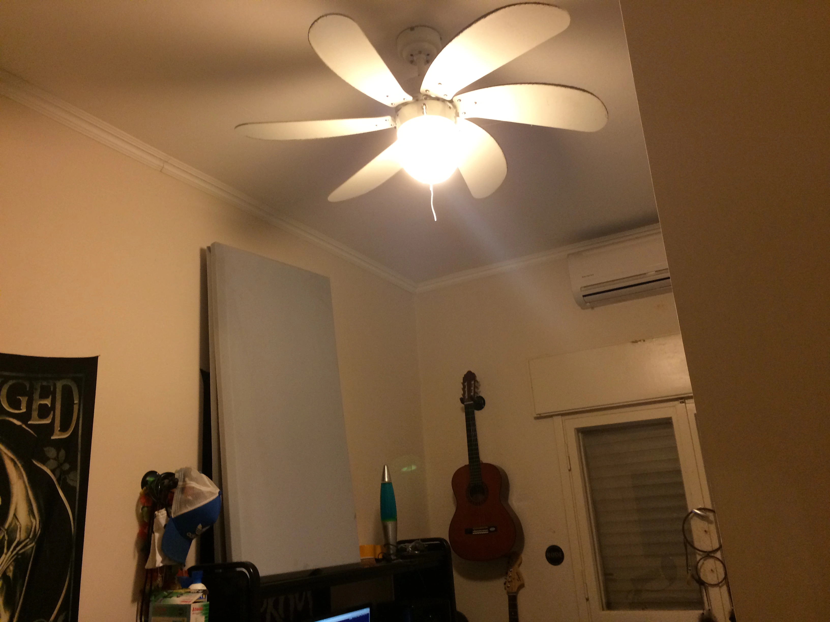

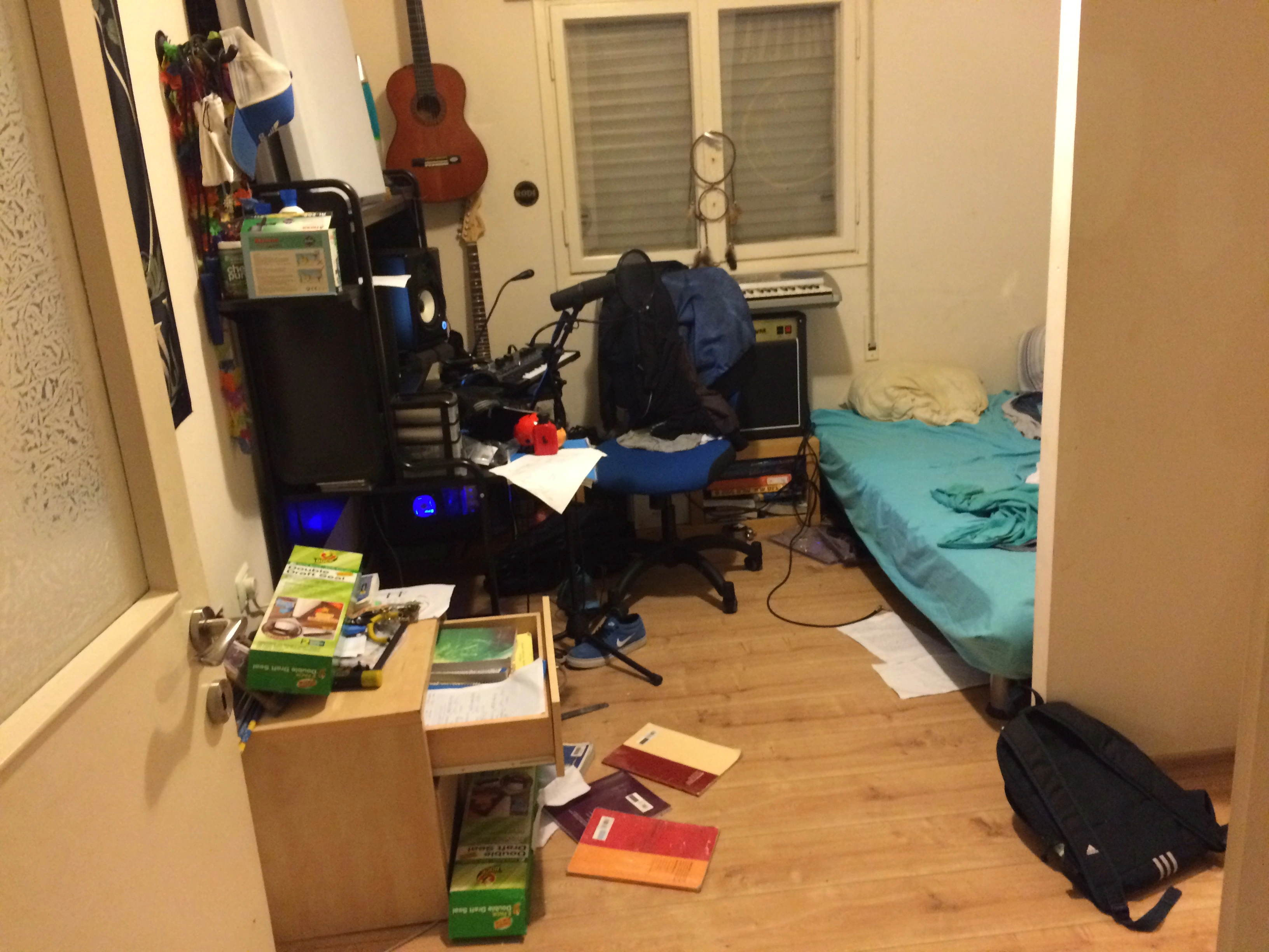

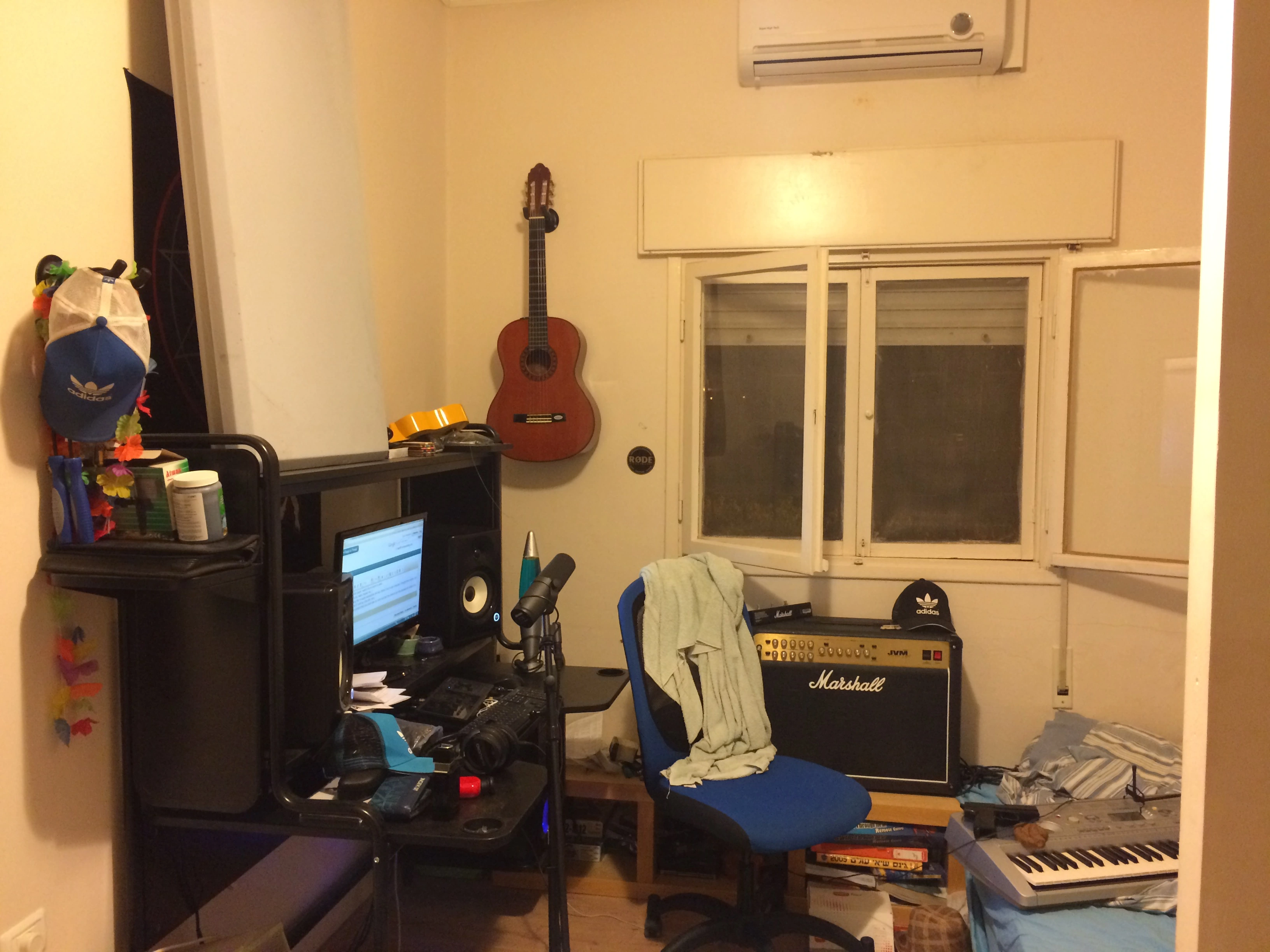

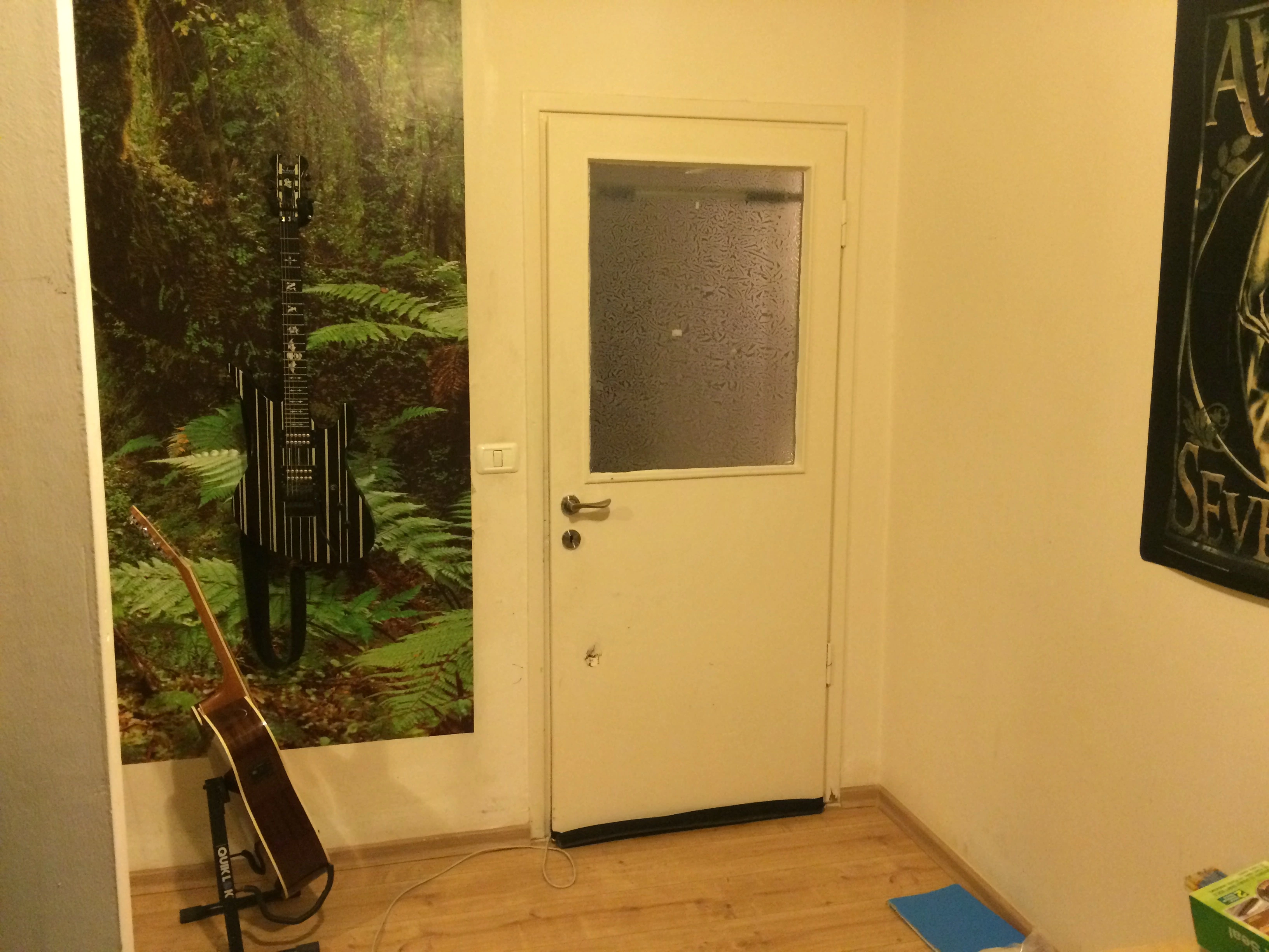

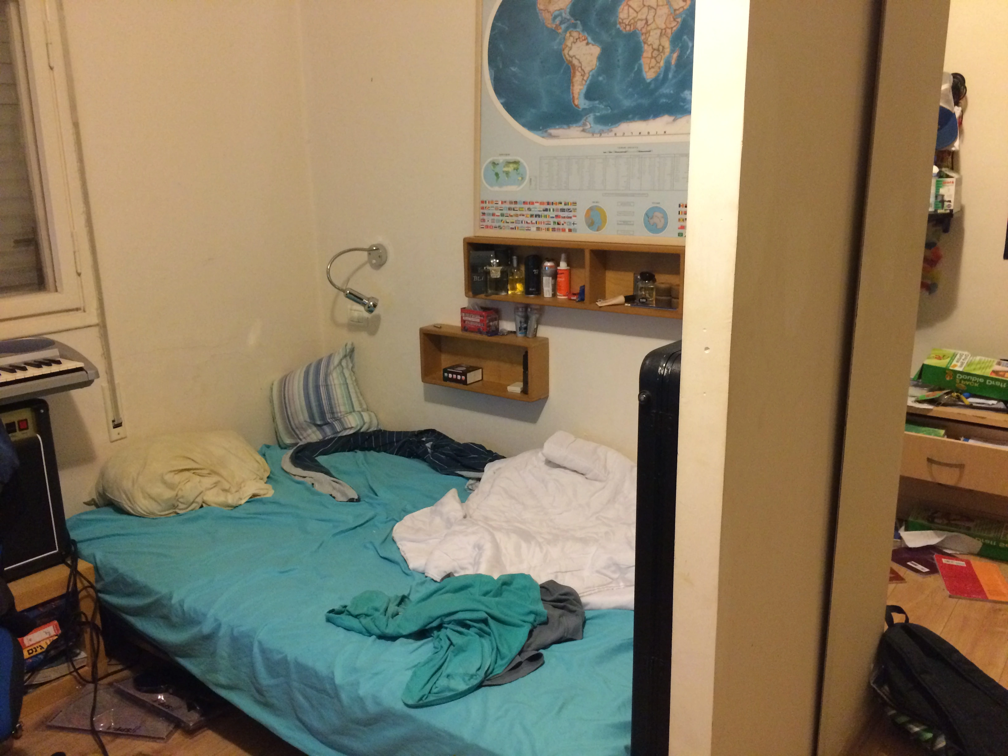

So heres some pictures of my room:
Make 4" thick traps (double up the 2" OC) with 1x4 frames overwrapped in any breathable material. Cotton sheets work and are cheap. Put the traps in the corners of the (not very big) room - that's 6 of them, then assuming you are going to keep your desk where it is, put one at the first reflection point on the wall with the window (it's probably right where the window is).
the other two - clouds above your mixing area is the best bet. Looks like this is a temporary space, so hang everything wiht hooks so you can move them easily when you move out.

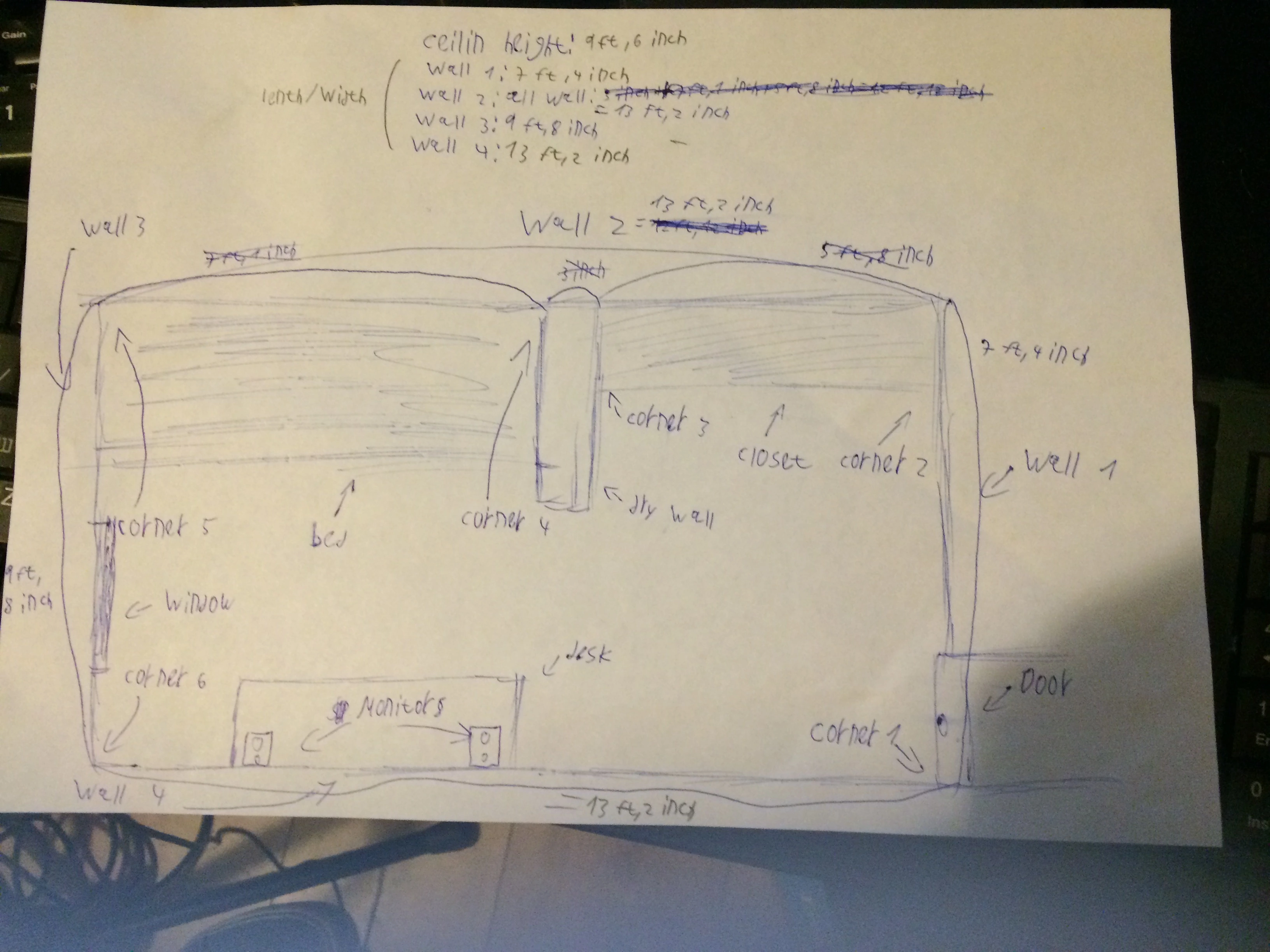

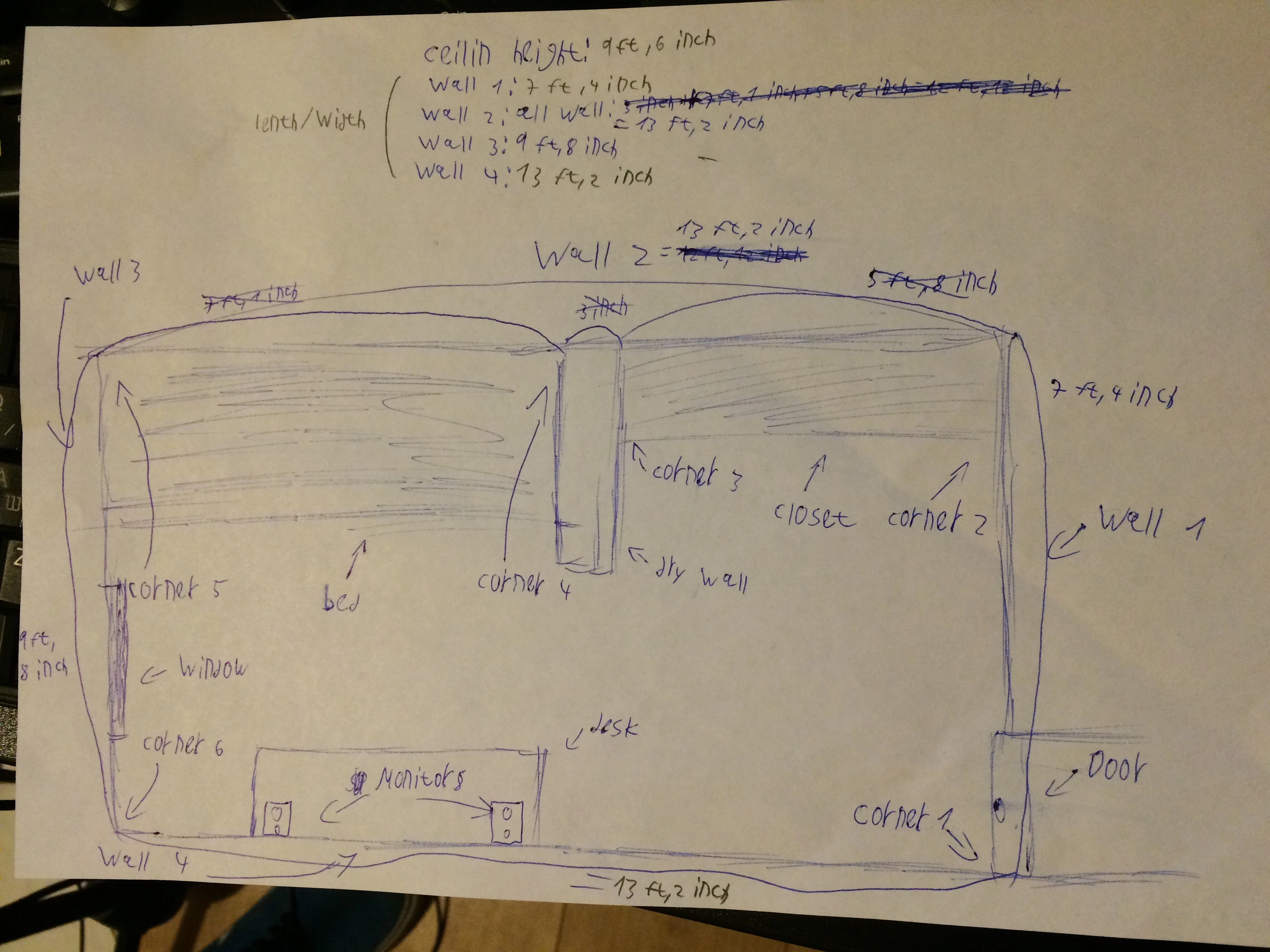

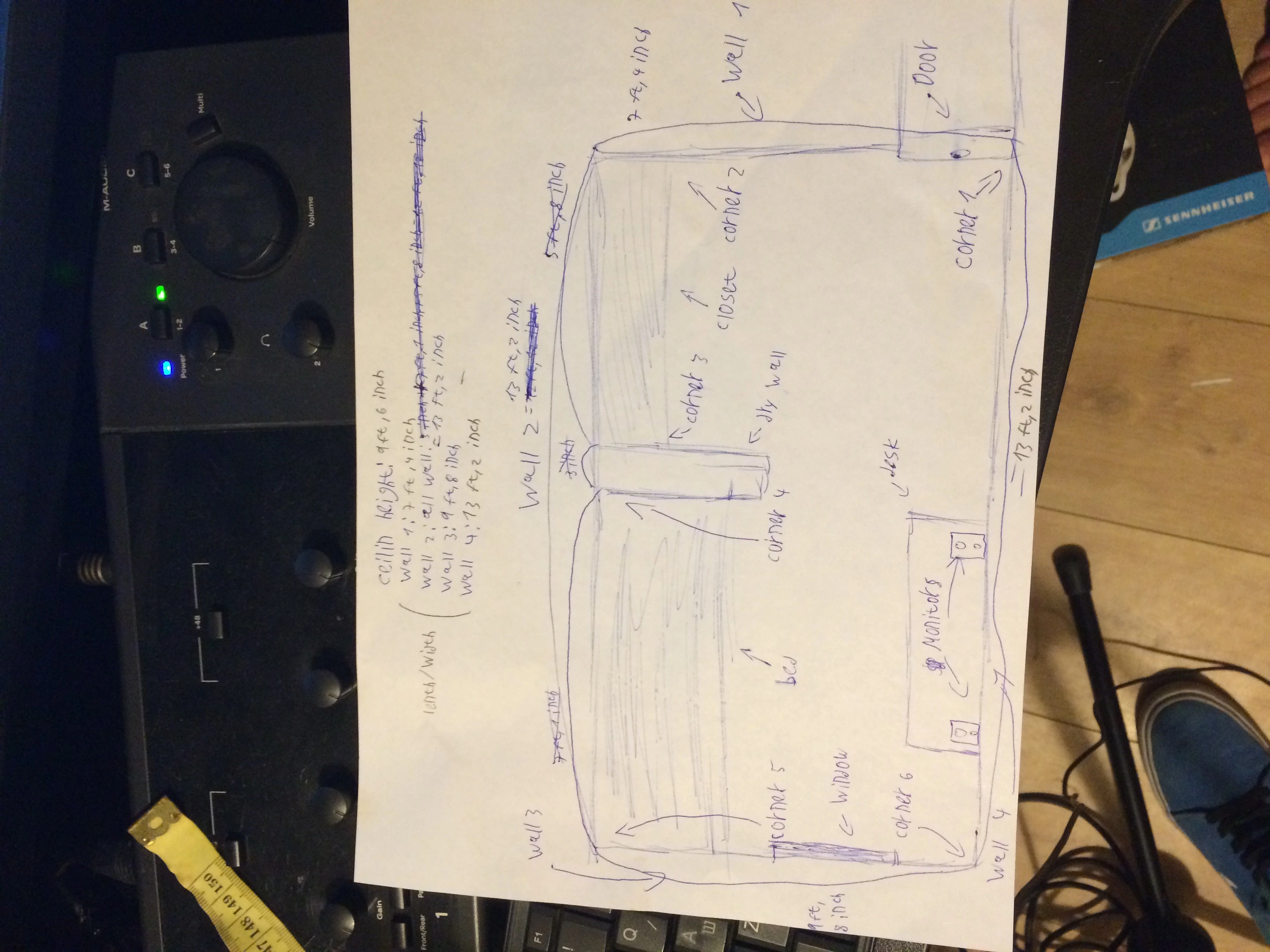

my ceiling is more then 8ft but i have a total of 6 corners in my room,ill draw my room room measurmants and upload.
well im not de vinchi but i hope this and the photos will help you to help me :) :
Forgot to mention that i have space to place bass traps in corner 1 if i need to
