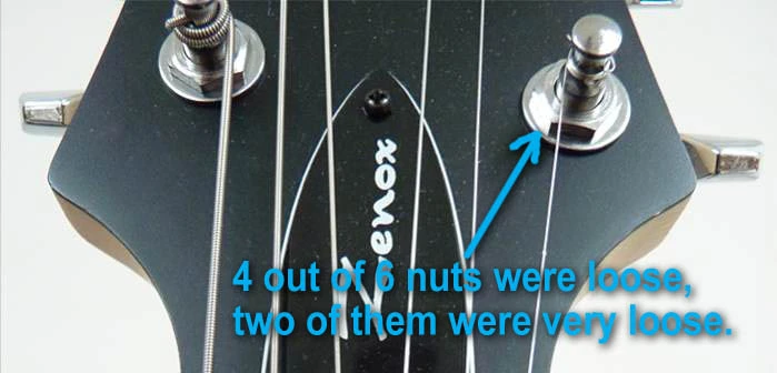

I receceived the replacement nut, a Graph Tech Black Tusq PT-6116-00 with 1.435" (1-7/16") E-to-E string spacingto replace the original plastic nut having 1.375" (1-3/8") string spacing. I'm pretty sure it'll work too; my acoustic guitar neck/nut are the same width as this electric guitar's, and the acoustic string spacing is the wider 1.435. Fingers crossed.
I thought you might find this interesting. Recall that I was having a terrible time keeping this guitar in tune.
While analyzing/measuring the existing nut prior to removal (so I know how to recreate it) I noticed that four of the six nuts that hold the tuners in place were LOOSE, two of them very loose. I tightened them up two days ago, tuned the guitar and have played it as usual. It's still in tune(!) These nuts on the face of the headstock appear to be the only means attaching the tuner to the guitar (no small screws from behind) so no wonder the strings couldn't hold tune.
The guitar came with a tag indicating which Indonesian was responsible for each step of production. Somebody needs retraining, or better yet, give that job to an American :D

LT BOB ==
yeah, I have seen that before ...... sorry I didn't suggest it.
Obviously if those tuners are tightened down and can move around, that's gonna be an issue. Glad you found the problem.
