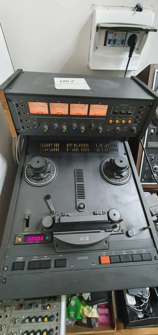

Hello fellows!
I had the chance to grab the OTARI MX5050 MKIII-4 earlier this week. i paid 500$ for it and got 2 tape reels too, not too bad.
It plays and record well on all tracks. heads feels pretty neat. cant wait to work the first project on it!
I will be glad to get some info from your guys regarding two issues:

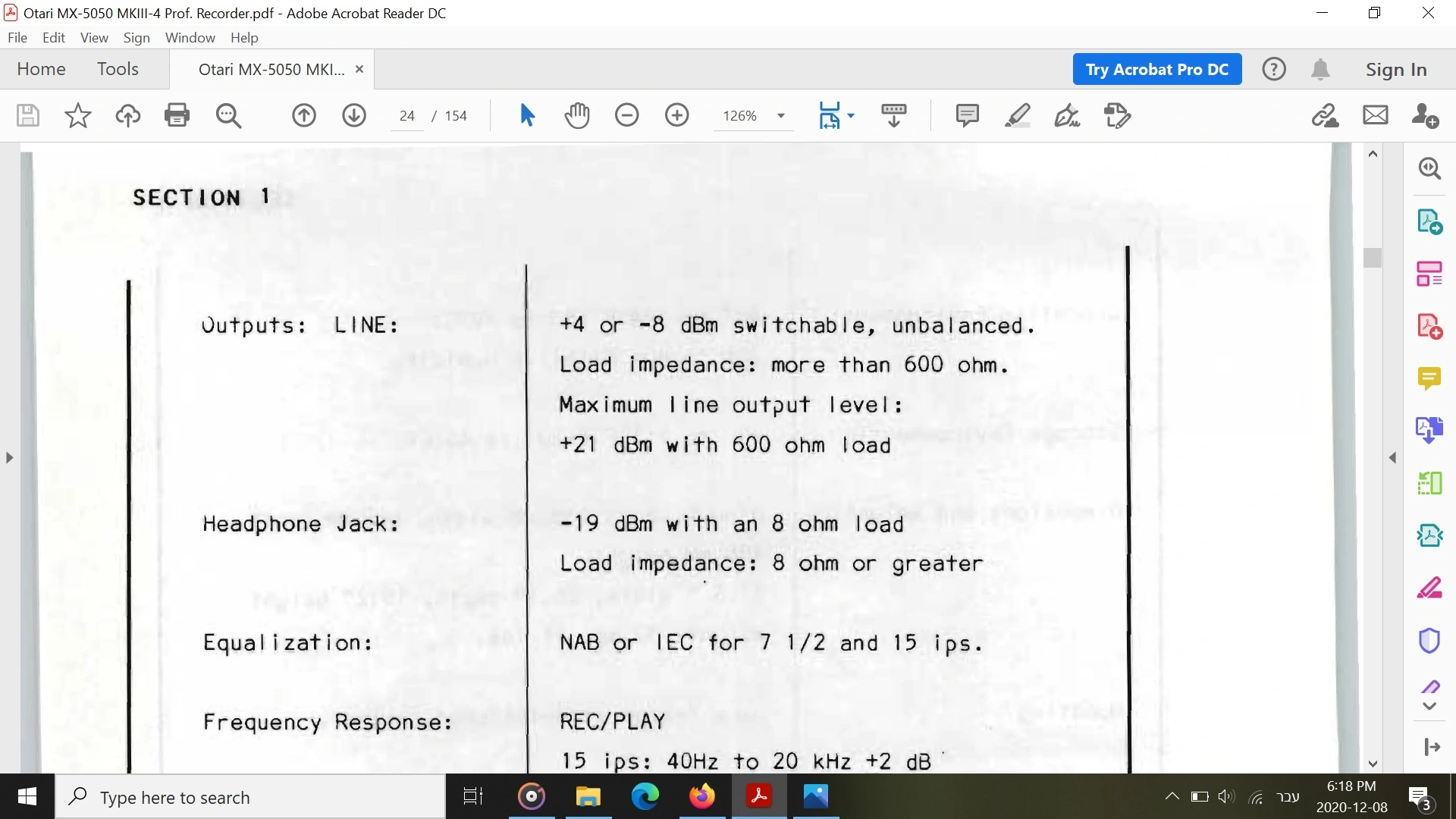

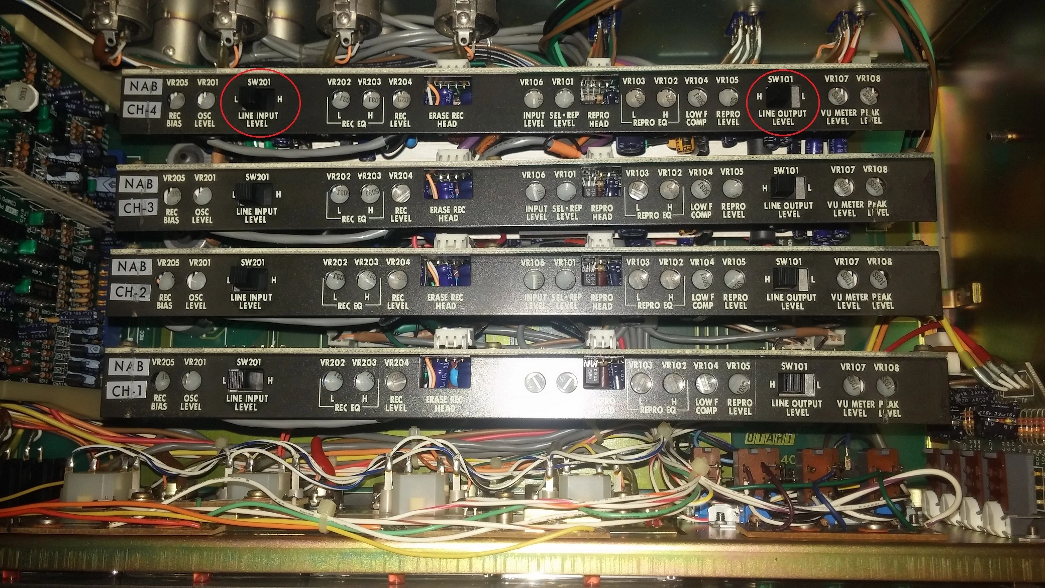

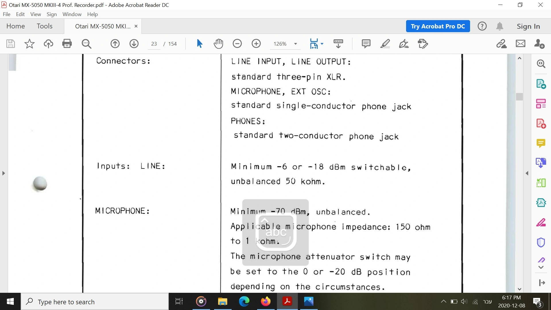

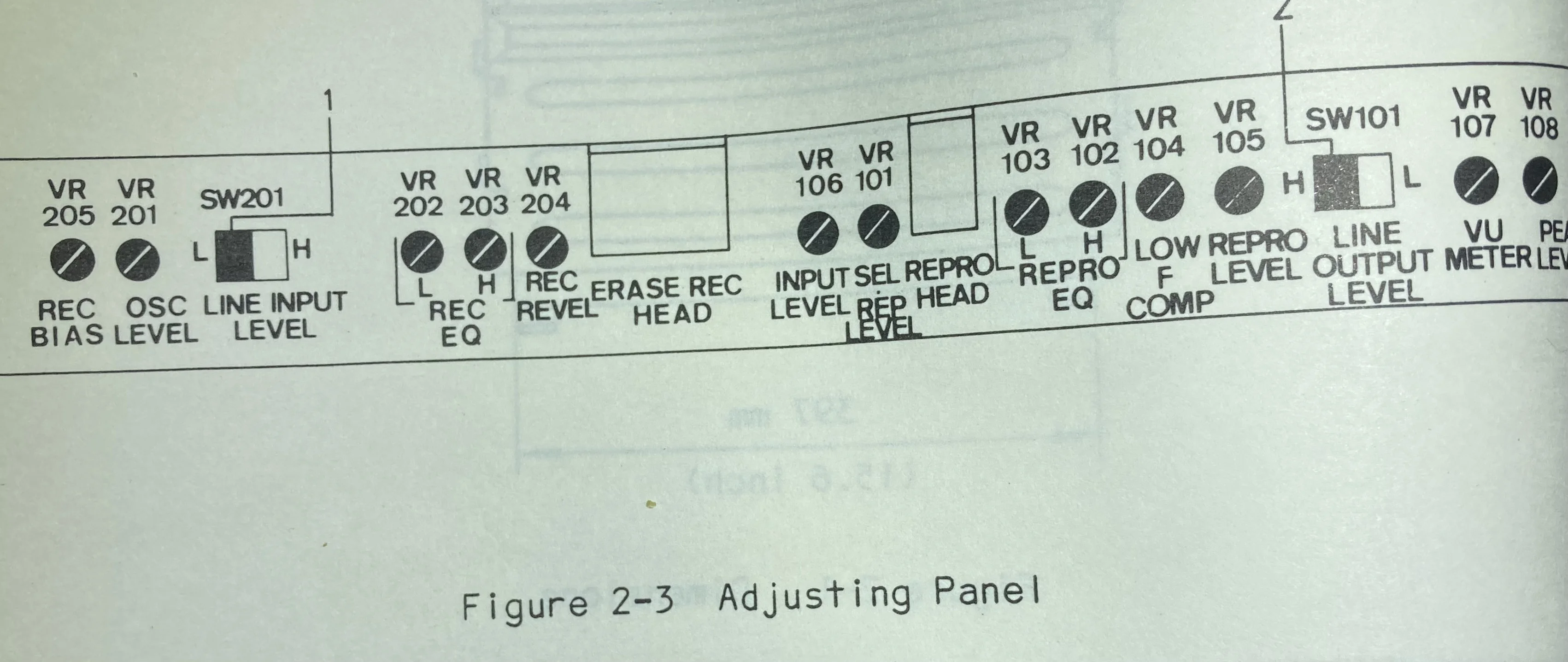

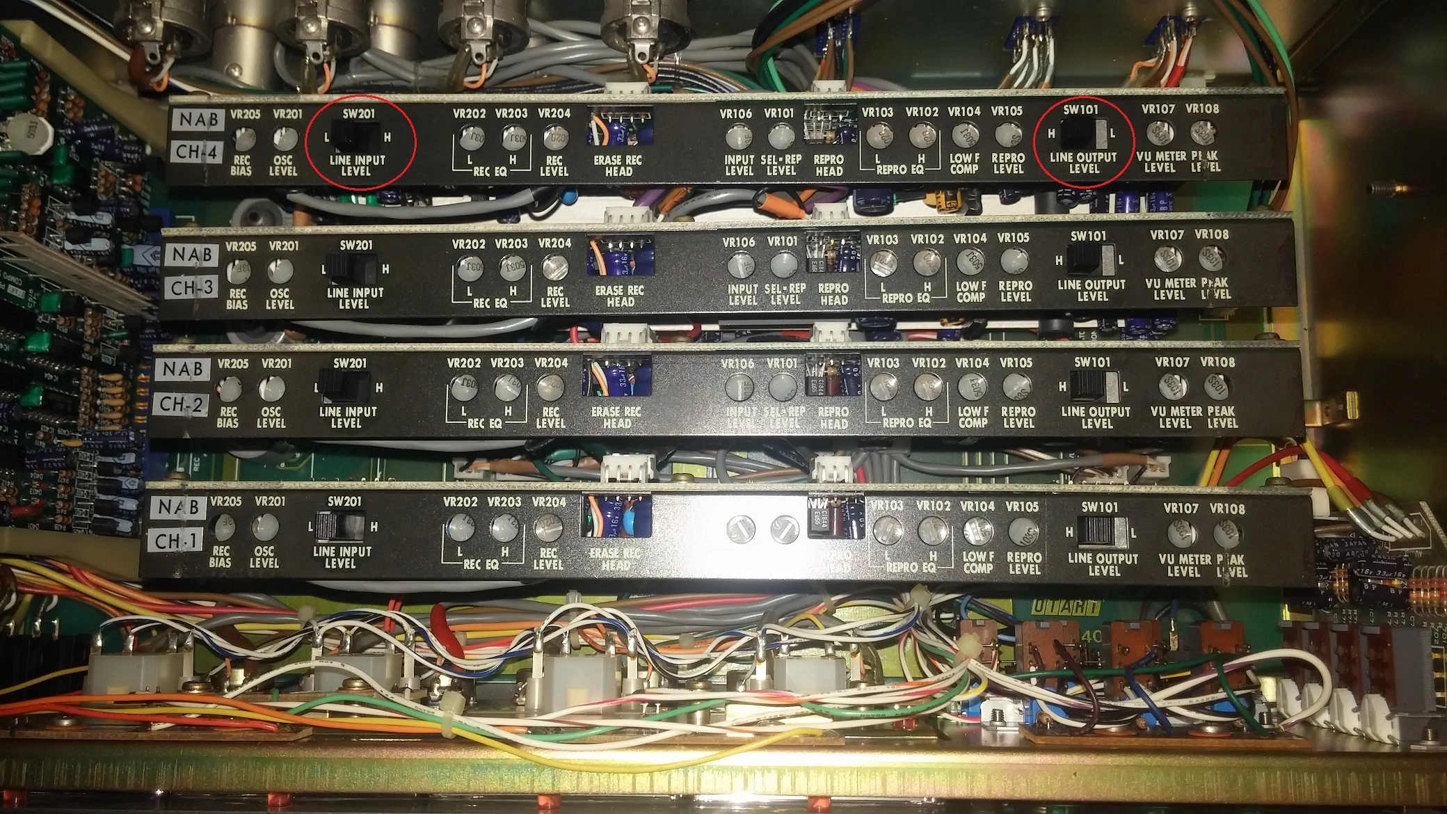

You motivated me to look into it deeply - i easily opened up the upper panel on the OTARI ,there i found the adjusting panel. as you can see, and from the manual:
the LINE INPUTS are switchable between "Minimum -6 or -18 dBm,unbalanced 50 kohm"
and the LINE OUTPUTS are switchable between +4dbm or -8dbm .
so if the Tascam offers +4 or +8 outputs, and the OTARI is either -6 or -18 , what is the right combination?
and on the other way same question, knowing that the tape in's on the M512 are -10dbm..?(correct me if i am wrong).

You need to tell me what outputs you are using on the Tascam. That will determine where you set the level switches for the inputs on the Otari. If you have the ability to make up RCA —> XLR cables for your console outputs to tape machine inputs, there is no reason to use the BALANCE AMP section of the console. The only reason to use that BALANCE AMP is if the inputs you are feeding with your console outputs are balanced, and high nominal level (such as +4dBm). The Otari is unbalanced, and has switchable input level sensitivity. So avoid all the extra balancing and level boosting/attenuating circuitry and just use the RCA PGM BUSS output jacks on the Tascam, they are -10dBv nominal level, and set the Otari input level switches to the -18dBm minimum setting.
The TAPE in jacks on the Tascam are not -10dBm, the are -10dBv, but that roughly corresponds to the -8dBm output level setting on the Otari.

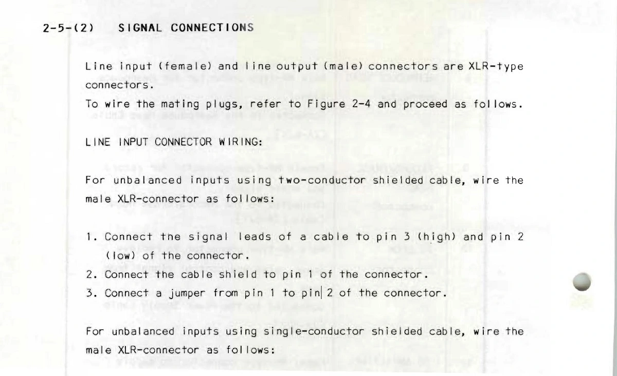

Post back if you have any issues. Otari is saying to tie or “jumper” the pin 2 conductor to ground at the XLR at the tape machine, but I would do that at the console, at the RCA end. Hope that makes sense.
You bet!
so at the tascam side - cable sleeve to ground, conductor 2 also to ground ,conductor 1 to signal.
at the otari side - sleeve to ground, conductor 2 not connected , conductor 1 to pin 3.
that's what you mean?

RCA end, just as you wrote above:
Cable sleeve —> RCA plug ground
Conductor 2 —> RCA plug ground
Conductor 1 —> RCA plug pin
XLR end:
Cable sleeve —> XLR pin1
Conductor 2 —> XLR pin2
Conductor 1 —> XLR pin3

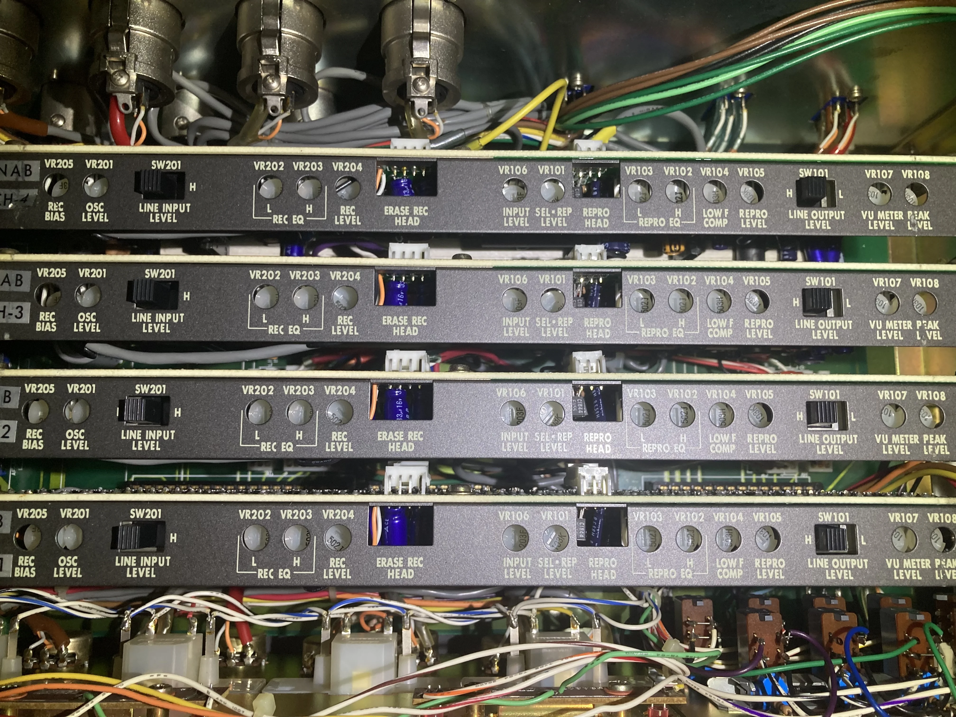

Hello,
Picking up this thread, I have same tape machine (Otari MX-5050 MKIII-4) & wondering if you or anyone here may know w/what electronics settings (adjustable <w/screwdriver> bias, eq, various levels, VU meter, etc <not the switches> accessible under top removable cover) Otari would have released the machine from factory set @?
The manual states:
5-2 TAPE REPLACEMENT
The MX-5050 MKlll-4 is set at the factory for Scotch #226 Recording
Tape.
If another tape is to be used, the following adjustment may be
required for optimum tape performance.
Refer to Section 7.
Required adjustments are:
1. The record bias adjustment .
2. The record level adjustment.
,& I’ve been able to get a reel of NOS Scotch #226 tape.
I found this thread through finding your photo of the electronics section (mentioned above) online & I’ll include a photo of where mine is set right now as well as a picture of how they have that section pictured in the manual (whether that tells us anything? <it looks like manual pic shows all set to either ‘zero’ [all the way counter-clockwise] or about 2 o’clock [whether pic is meant to be showing anything here in this respect? {I know it’s showing the switch position, @ least}]>).
I put all my EQ @ 12 o’clock so far (just guessing) & kept the bias & level, etc ~how I they came when I bought the machine used (I’m not as sure about bias & level yet, & guessing the EQs are or can be a question of taste per channel etc <if not set for specific tape>?).
I know (& guessing to whatever extent) that there’s general calibration, alignment & maintenance stuff needed along the way (I guess regularly, semi-regularly & depending on condition of machine & what tape being used etc) & I read over some of those protocols in the manual if/as necessary.
Just wondering if, again, there may have been general factory settings that will help it work @ optimum level since I’ve been able to track down the tape that it was originally designed to work w/? (I know it can work w/other tape, too, of course, w/whatever proper adjustments <as manual states>)
Thanks everybody for help in advance & any & all guidance would be greatly appreciated!, whether along the lines of my questions &/or general guidance on all this, as I’ve done some tape recording to whatever degree & to some good effect, but definitely learning & need all the help I can get!

First and foremost don’t use Scotch 226 tape at this point. It is notoriously sticky shed-prone. You can and should use any new +6 class tape like any SM911 variant.
And yes you’ll need to, at minimum, go through the bias set procedure.
And now on to your trimmer tweaking adventure…you DO NOT perform electronics calibration by visually setting your trimmers to what somebody else did, be it in the manual or somebody’s pic online. You do it by following the procedures in the manual using the prescribed test equipment (reproduce test tape, audio signal generator, audio level meter, oscilloscope, etc.) And if you’ve gone ahead and started tweaking trimmers haphazardly, by setting all the EQ trimmers to 12:00, you have now upset whatever was done the last time the machine was calibrated, if it was even calibrated correctly and for the tape you are using, and there’s no return without going through the procedures in the manual. NO the EQ trimmers are not intended to be adjusted to taste…these are not used like EQ pots on a mixing console, they are used in conjunction with the required test equipment to trim the tape machine’s frequency response to spec, and they work in conjunction with the record level and bias trimmers…yes there may be deviations one employs from the response curve specified in the manual to suit their tastes and their environment and primary program content, but these are all verified across all four channels using the required test equipment. Once the calibration procedures are finished you’ll find none of the trimmers are quite set the same section to section, and this is because of minor differences in component tolerances throughout each channel’s signal path as well as tolerance and wear differences across each tape head track. That’s why there are trimmers…because there’s drift and tolerance differences and all the parameters represented need to be adjustable to compensate and ensure each track performs the same as the others and within the factory specifications, and the adjustments need to be made with measurement from the required test equipment. If you don’t know how to properly calibrate the machine or if you read through the procedures in the manual and they feel out of your reach (like you’re not comfortable with them and you do not have and/or know how to use the required test equipment), it’s time to take it to a tech and get it setup. But get some new tape first. You do not want to use Scotch 226.
