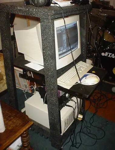

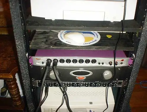

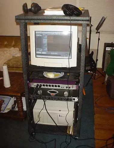

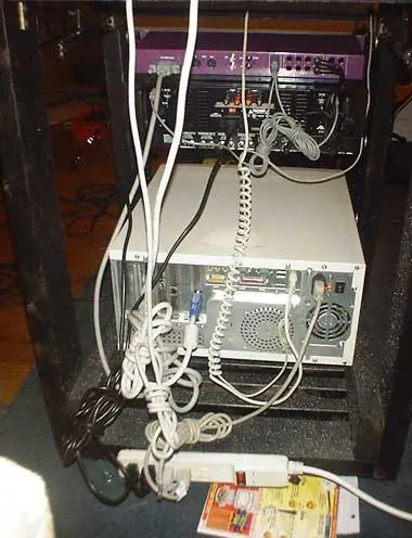

Ok...I have had this thing for a while and have made changes to it a couple times, but it is finally done. I wanted to post it for you guys and ladies.
The rack is made from 2x4's with a peice of plywood for the top and *other pieces of wood for the top molding. It has a pull out keyboard stand and a 10 space rack for the bottom half. There is a surge protecter on the bottom section. It sits on four lockable heavy duty casters.
Parts list
5 - 10 foot 2x4 studs
1 - 19'' wide x 22" deep 1/2'' plywood
1 - peice plywood for drawer (18" x 14"?)
2 cans black paint
1 can black rock textured paint
Keyboard drawer hardware
Lots Of sheetrock screws assorted sizes :)
4 casters
Probably about $60 total cost
