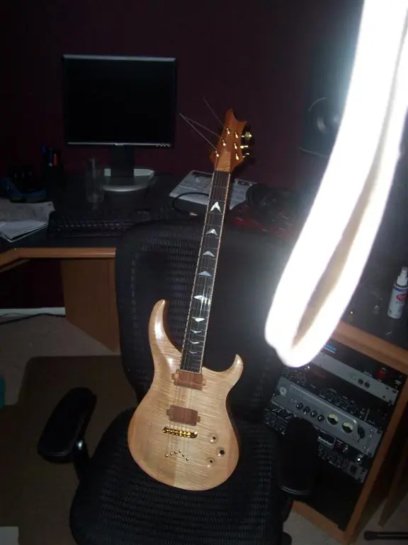

Here's another pathetically amateur picture. :D
That white strap reflected all the light back into the camera.
Set it up against a neutral wall or with a sheet behind it.With the effort you've put into that guitar it deserves better.

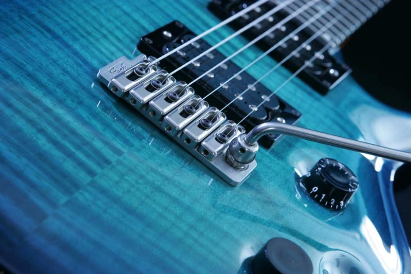

Just some observations.........if you look at the first pic in post #20 you'll see where the light highlight/reflection is just above the p/ups, there are two points where there's a bit of a bump, using your thumb, run it along that area and see if you can feel the variation in the contour line, if you can, then on your next build use that technique to check your shaping.
Creating continuity in the contouring is critical, the ultimate aim is to have a sense of flow across the whole surface, actually, that sense of flow or connectivity should extend throughout the whole instrument. Not wanting to impose but the surface contouring in this pic may give you some ideas.........
