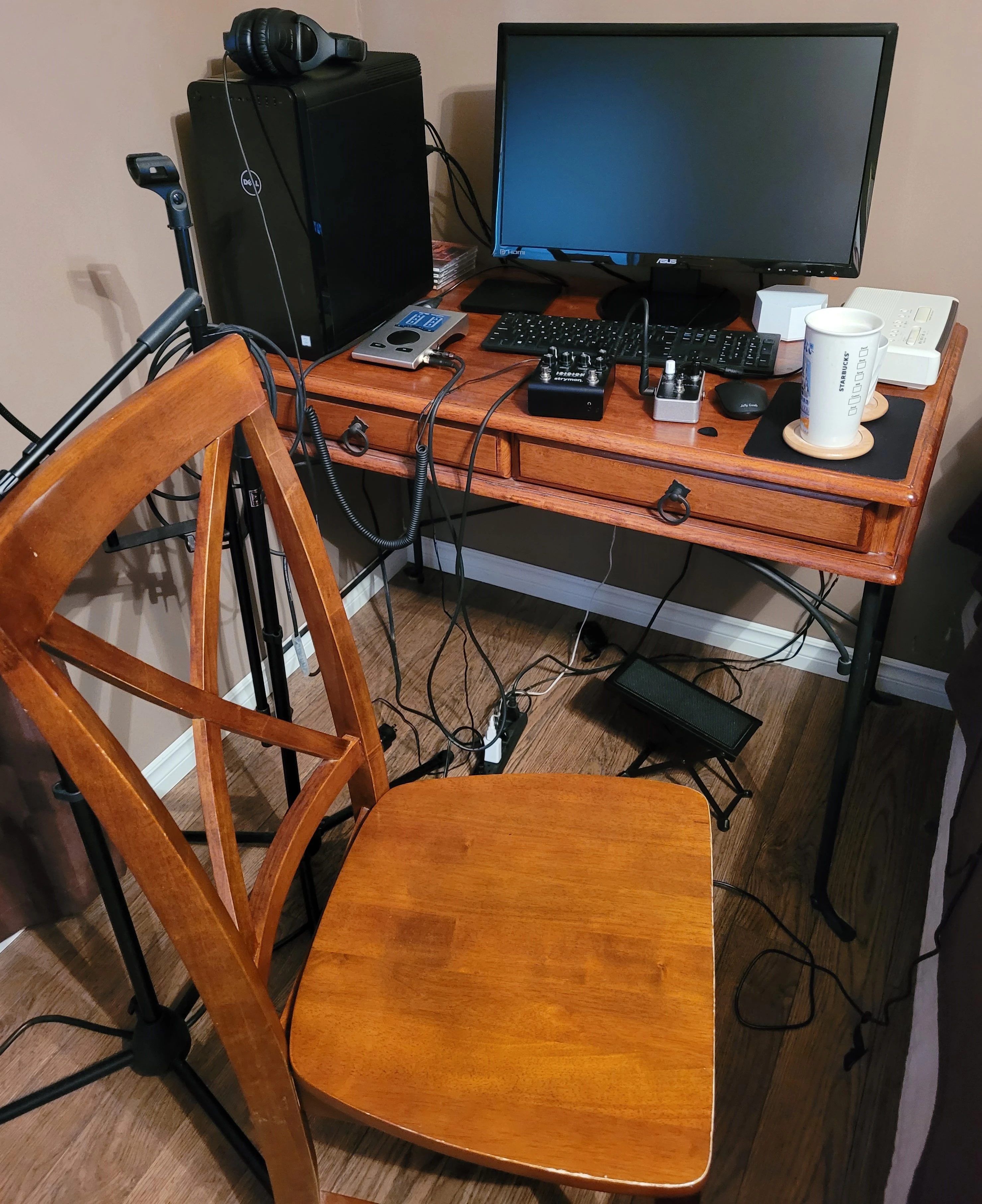

I have had a very small area to work in but that is going to change as I am moving into a new house in May and will finally have a spare room that will be a studio/ office space. I have a modest setup and it will stay that way, but I still need more space and will finally be able to have a much bigger workspace. I included a pic of my current setup situated in my 'man corner' of our master bedroom (very, very cramped). The workstations designed for home recording have shelves to elevate the monitor, but I don't want to do that; I like the monitor location right where it is the way I have it. I just want a much bigger table and I would then have room to put the speakers on, something like these, and have them directly on the table for some slight elevation:
I'm looking for table suggestions or suggestions in general, please! :-)

Doesn’t look like you have a lot of stuff. Seems like just a slightly bigger desk or table would work.
Get some stands for monitors and put the computer on the floor and you’d have better set up.
Your wife can use the existing table for a make up desk ?

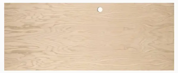

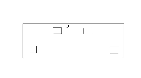

You don't have to be real handy to build your own desk. Just some access to a few tools. Based on the room I was using at the time, I took a 4x8 sheet of birch plywood, cut it down to 32" x 8 ft, rounded off one corner (because it was near a door opening), and cut some 1"x 4" notches in the back to pass cables through. I bought 4 table legs that screw into mounting plates (screwed into the bottom of the desktop, and with the 16" x 8ft of wood that was left, built a double shelf to go underneath (that also supports the center of the whole desk), and a couple of small shelves for the top. I stabilized the whole thing with a couple of 'L' brackets attached to the top and screwed into the wall. Stained all the wood and had it in place in an afternoon. When I divorced, it was easy to take apart and set up in my new space.

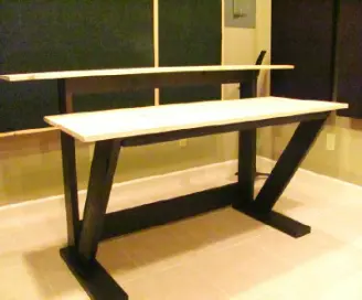

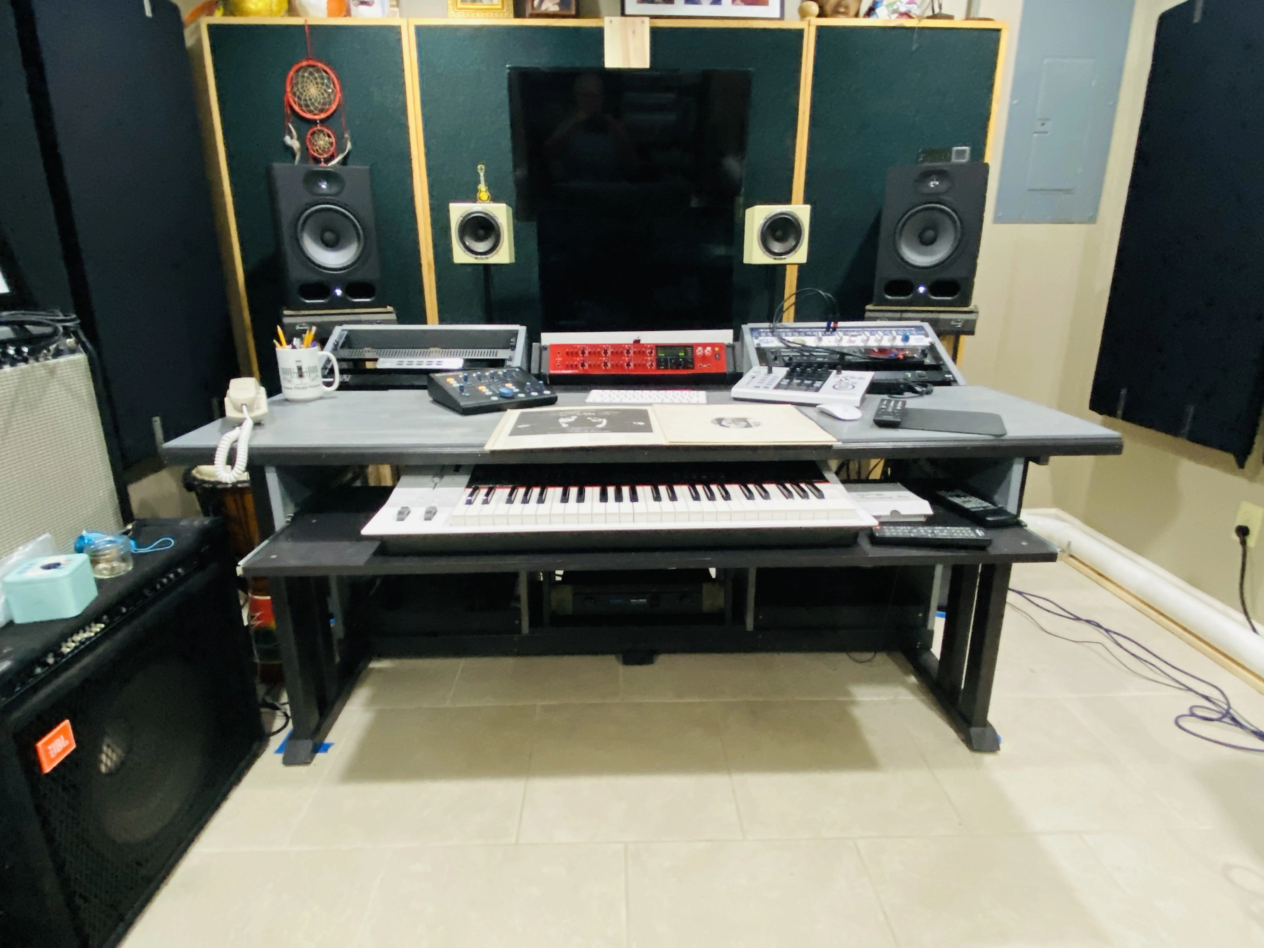

Designed and built this desk above in 2009 for $50. Sold Build Plans for it, too.

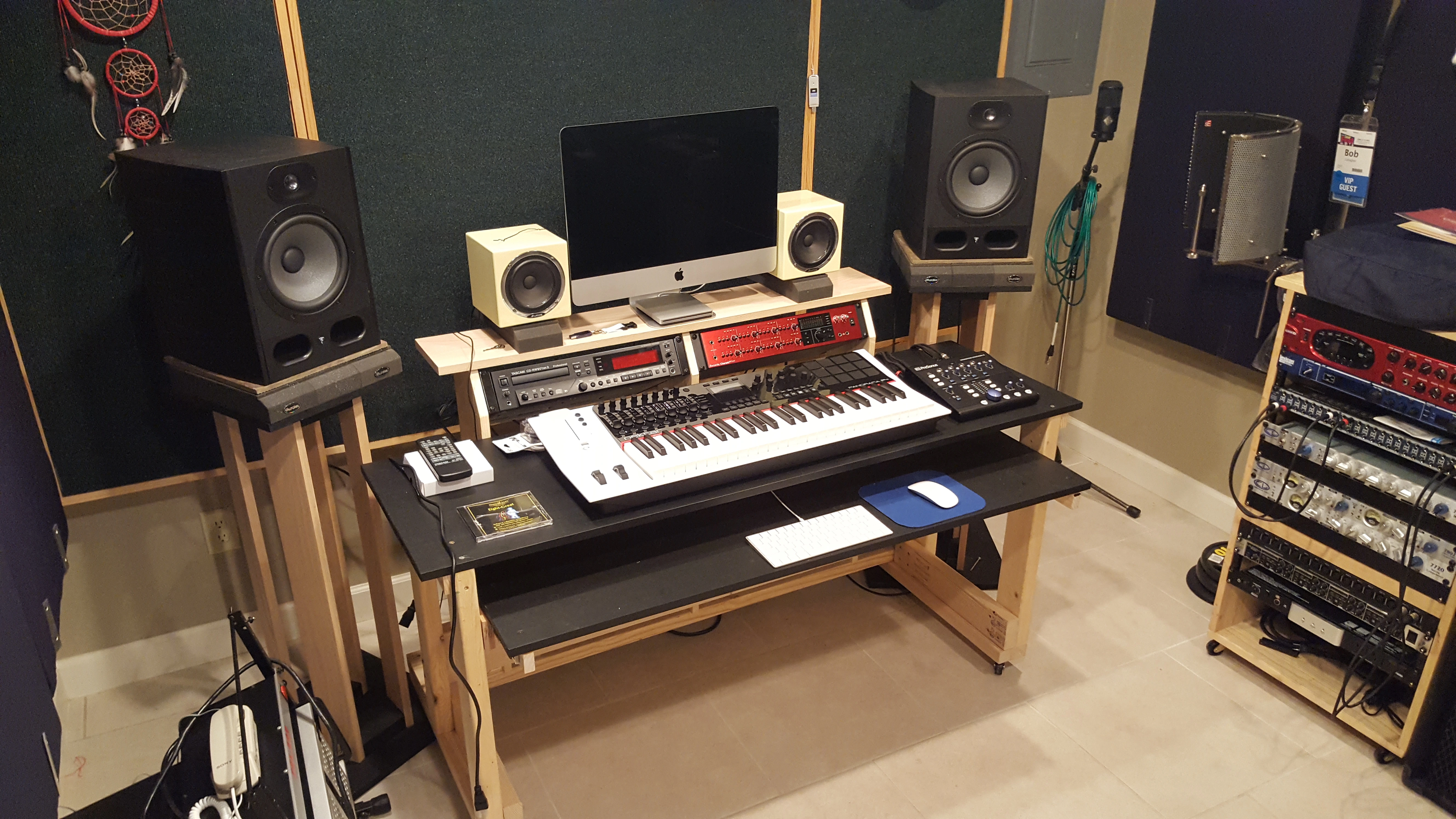

Built this desk above for $100 (and rack and monitor stands and frameless oc703 black acoustic panels and my "Black Hole" Bass Traps behind desk).
I designed and built the desk, above, for about $150 but used the sliding keyboard drawer from the previous desk that cost about $40 for wood and sliding drawer rails.

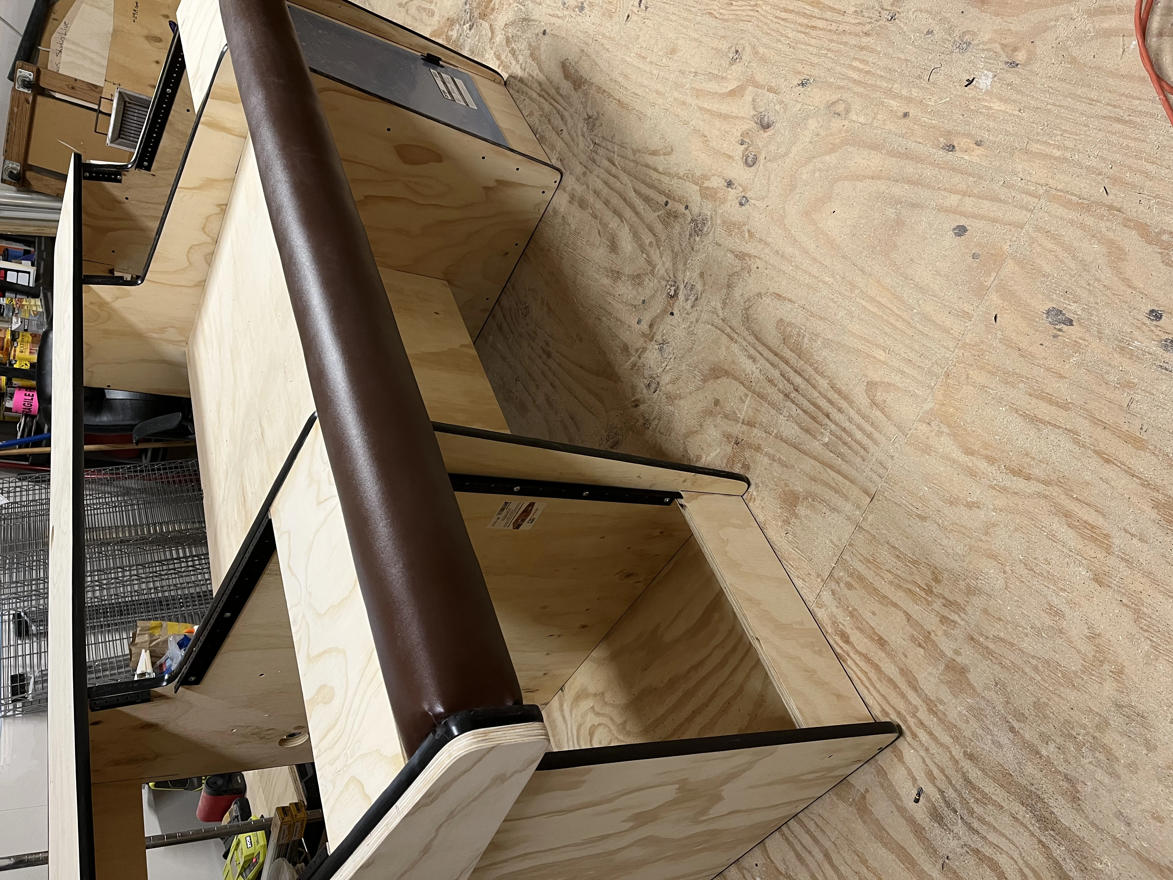

I just bought this desk from Don Hawkins in Oklahoma. Hawkins Studio Consoles He made it to fit my Tascam M-520 console. Perfect for my needs with tons of rack space. I’m finishing it with stain on the sides, and Formica on the top shelf and desktop surfaces for a punch of color and durability.
