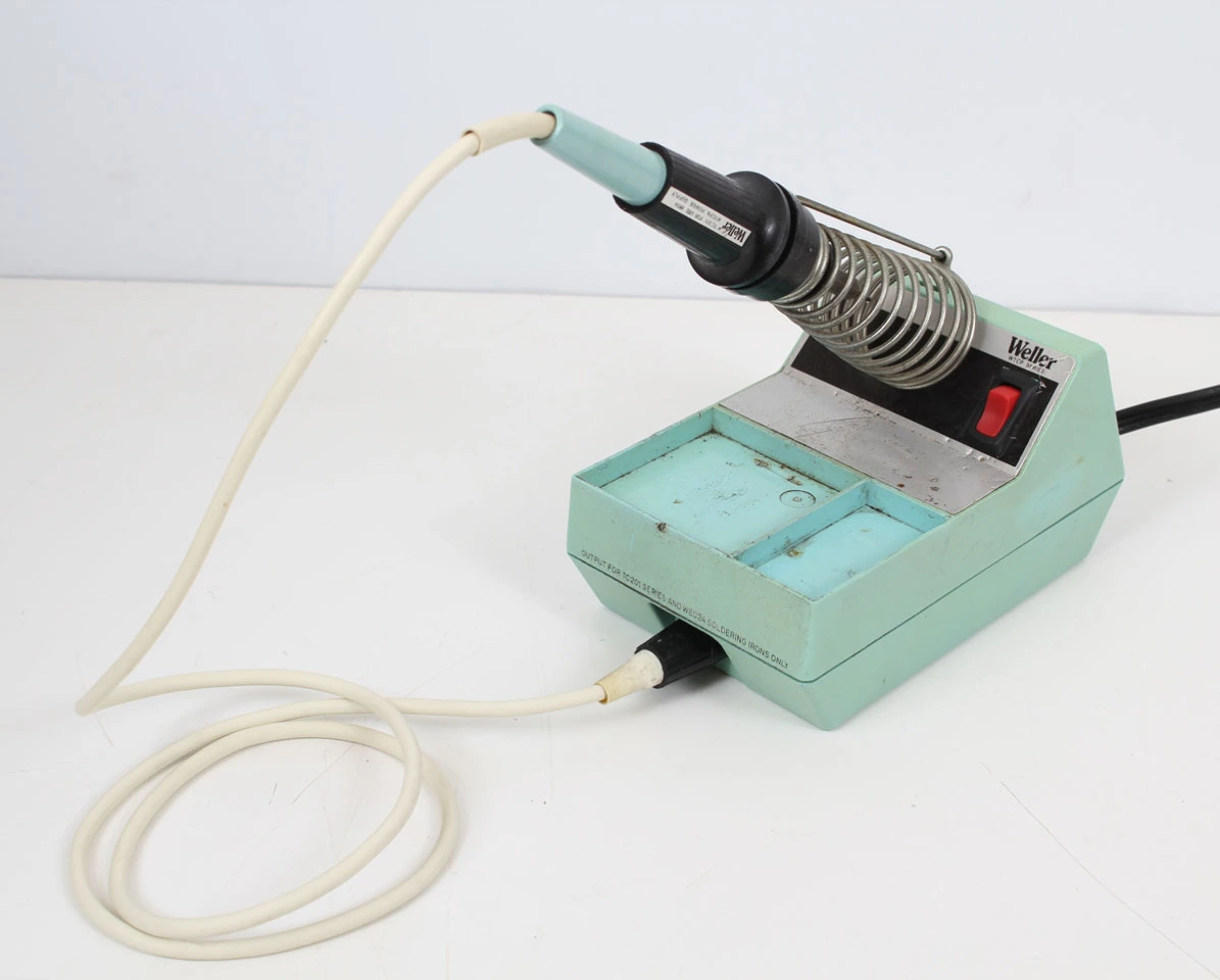

Miroslav, mate, (may I call you mate?) There are many things you are I can never be and many things you do I shall never be able to but. If you are effing up solder iron tips you are doing it wrongly mate!
I soldered for a living and for 'fun' for the best part of 50 years and used the same iron, a Weller Magnastat for all that time. Despite doing a score of joints and more a day, every day including Sundays I did not change my tip more than once a year if that. This is the tip care told to me by Weller techs when they came to the factory where I was in charge of around 50 solder stations.
1) Do NOT wipe the tip on a damp sponge, the thermal shock cracks the Iron plating. Instead wipe with brass wool or kitchen paper.
2) Keep the tip tinned at all times. Once up to temp, tin and wipe, tin again and solder. Wipe and tin regularly throughout the work.
3)Never attack the tip with a file or emery paper, again you will break through the plating. Instead keep up a regime of wipe-tin-wipe to clean oxide off the tip. In extremis you can buy a tip cleaning paste but use very sparingly it is very aggressive.
4)Do not leave the Iron 'cooking'. Prepare the work 'cold'. Modern temperature controlled irons are up to temp in 30 seconds.
5)When done, wipe the tip then flood with fresh solder and allow to cool.
Apologies if you know/do all that but if so I cannot understand WTF you are doing to those solder tips!

Nay a problem laddie! You don't need a new solder station T, just some new tips. ASSUMING you can get the barrel off the iron (do it cold and if you MUST use pliers on the fixing ring be careful!), you can get tips of different styles and temperatures*. The irons are normally supplied with a #7 'chisel' tip, about 2mm across end. This is, as you have found, fine for almost all general work on old 'P2P' chassis and cables and 'thru hole' PCBs and Lead/Tin solder. For PCB work on Pbfree gear a #8 is needed. For chunky Pb free work, big ass switches say, a #9 with a buff, 5mm tip is fast but beware! A #9 tip will ignite paper!
Lastly, if fine PCB work is envisaged go for a #8 'needle point' but these are not as strong as the thicker tips although you should get a good year out of one with care.
If you CAN'T get the barrel off, don't struggle, you will wreck the iron. Keep it as backup and go for my suggested station.
*In case peeps don't know. The Weller works on the 'Curie Point' principle. A magnetic switch in the barrel is operated by a special alloy at the base of the tip. At a certain temperature the alloy loses it magnetic property and the switch drops out, tip cools a bit, power flows once again. 'KING clever or what!
The switch can fail and can be replaced but you will loose hair and fill the swear box up trying! I got it down to about an hour's cursing after about my fifth switch swap. N.B. I was looking after over 50 stations and they were each doing 1000s of joints per 8 hr shift and many were heavily abused. Could NOT get most of the fekkers to switch them off!
I have used Weller irons for the better part of 47 years and I have used wet sponge cleaning method for many years with the tips lasting more than a couple to few years- I stock a lot of them and different sizes but that item from China will not be supported for very long and they do not care about the customer but it is already not available. I buy well known name brand products and even have spare stations on hand. The Weller products have worked for me for many years and I work 8-14 hour days not always soldering. I do not leave them on all day like some shops do. The cause of tip failure has to do with lack of proper maintenance as in letting it corrode up and doing things that the tip was not designed to do like pry up metal parts. In all my years using a wet sponge I have never had a tip crack or break from using that. It helps get bad solder off and solidified so the sponge can be cleaned off at a later time. Sponge use is also a learned method- some guys gouge the tip into the sponge when they are suppose to use the surface of the sponge. When you use a product wrong it does not serve you very well in the long run. I get years out of my tips and on my Edsyn DS0017 I have never had to change a tip yet.
Yup,I agree with most of that Sky except the damp sponge. I told not to use them by Weller technical chaps no less when they came to the factory to assist the changeover to Lead free solder. They told me the water causes thermal shock and can crack the iron plating. This is admittedly a more serious problem at Pbfree temperatures. I had been a R&TV service tech for 30yrs before and used a 48W Weller Magnastat every day WITH a damp sponge and rarely buggered a tip but that was with old 60/40.
There is difference I think between guys like us who know the drill and care for the kit. The (mostly) girls at the factory basically didn't and were soldering millions of joints a year. I suggest newbs avoid wet cleaning. Kitchen paper works very well indeed.
I had a brief time at "J Beam Antennas" soldering PTFE coax and other RF kit. No water there matey! Brass wool.
