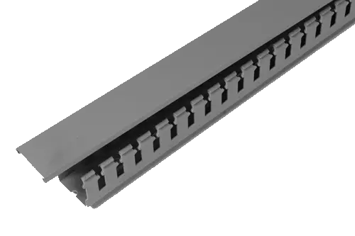

Go to an electrical wholesaler and ask to see some slotted plastic cable tray. If you get a profile that is wider than higher you can lay it on the floor put the cables in and click the cover on. If you need to have a cable come in or out along the length you can feed it out the slot.
