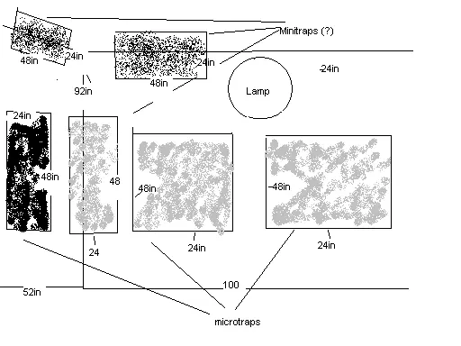

hey you guys..iv decided to buy a some HF MicroTraps from realtraps.com (i was told they work great)..im trying to treat a corner of my room for good accustics on vocals..what do you guys think of this config? everything grey is the microtraps..all the mesurements are there..(not really drawn to scale)
picture attached!

I'd stack two of the 24" x 48" traps on top of each other to cover the entire corner floor to ceiling.
> im trying to treat a corner of my room for good accustics on vocals <
I wouldn't bother with a MicroTrap across a corner as you show in your drawing. Corners are good! But for that placement you'd get better results with a MiniTrap.
So my best advice is to get one HF style MiniTrap plus two or three MicroTraps. The HF MiniTrap will be mounted straddling the corner, and placed vertically so the top is one foot above your head. Then one or two MicroTraps will go flat on the walls adjacent in the corner at the same height. When you call to place your order I'll be glad to make you a custom drawing if you remind me.
--Ethan

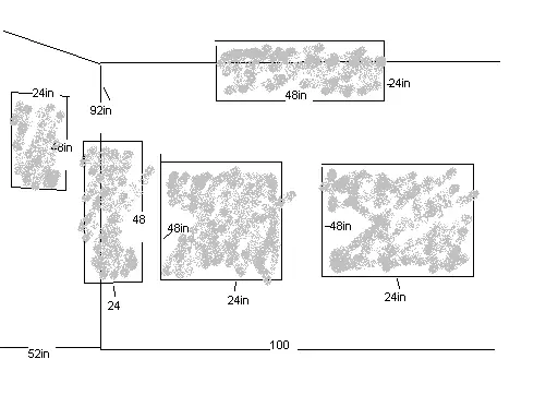

hey ethan..didnt realize it was you on the forums..im the dude that sent u those couple emails..thanks for all the help:-) ...so your saying replace the micro trap straddling the corner with a minitrap..what about the one on the corner on the cieling...should that be a minitrap as well?...thanks alot!
heres a little updated sketch...i just realized i have a lamp that i cant move thats on the wall..so what about this

> what about the one on the corner on the cieling...should that be a minitrap as well? <
Yes.
> heres a little updated sketch <
That looks good. Really, you need both high and low frequency absorption, not just one or the other.
--Ethan
so this configeration only gives me low absorbtion? what do i need for high?..i figured this would take care of both
> so this configeration only gives me low absorbtion? <
No, I said it looks good.
