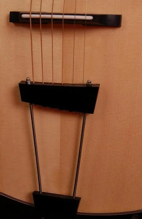

The thing about it that would intrigue me would be the effect of the rigidity of the tailpiece. I've done hundreds of floating bridges over the years but none that anchor the saddle and tailstop as one. Sure the old Les Pauls had similar but it was passed over from a playing point of view. I'm not sure why they'd want to revisit. I like to have as little mass as possible there in an attempt to drive the top as much as possible. Admittedly not as critical on a solid body but that tailpiece is going to be an energy sap. I haven't seen one yet but would like to see how the feet are fitted. If you don't have good contact thats going to drain even more of the wood tone out of it. You want to get the string to take on the higher partials that the wood produces as it vibrates.
Like I say I haven't seen one yet so jury is out. I like to keep things light and stiff around the bridge.
Here's my take on the floating bridge and tailpiece design that I've just about settled on for my archtops these days. I've done them with all sorts of curves and lines but like to keep them light and simple. Not a great pic but the best I could rustle up right now. I have some better somewhere.

I see what you mean about the bridge and tailpiece being a relatively rigid assembly and how that could attenuate the strings' energy. I also wondered about those feet but the pictures make it impossible to see what kind of contact they are making with the body.
You have to remember that Les Paul was essentially an archtop guy. He grew up playing them in both his Country and Jazz days. Gibson claim it is based on his original design and there is no reason to doubt that. It is almost certain that his influence would have been the traditional archtop floating bridge.
At the time he was also looking to get a pure sustain from his designs owing to the fact that his early pickups where pretty inefficient, at least on his prototype stuff. He swapped out nearly all wood components for metal wherever he could, However wrong he was in that is not the point. The fact that he did it and made it work eventually is the great thing.
My guess is that it is pretty true to his original concept and as such it gets a thumbs up from me if only as a tip of the hat to a man that took things apart and put them back together his way and made it work.:D
