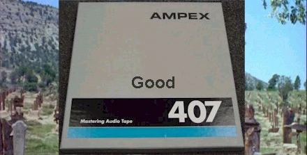

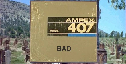

Good to hear. So you've dumped the 407 and gone with LPR35... That's probably a good thing. Since a bad capstan belt won't affect rewind speed I still wonder about that Ampex 407 you have. Just to be sure here are some pics of good and bad tape as identified by the box style.

Great illustration!
Ha! Classic, Tim! Well done my friend, well done... :D
The 407 I have is the good stuff. I need to give it a try now that the machine is working.
I take that back. I put it on and it slowed down the machine. I pulled it off and sure enough there was sticky stuff starting to build up on the heads.
It has the packaging of the good stuff - is this possible?

It's possible the tape was bad out of the box, but a bit unlucky. The box style was changed slightly before the new formulation came out... both in 1994. I’ve never personally experienced or heard of any bad 407 456/457 in the new style box, but there was a very short run of old tape in new style boxes.
For 10.5” reels you can look at the date code on the box and I recommend only 1995 and later to be safe, even though the formulation changed in late 1994. With 7-inch Ampex there is no date on the outside so you have to go by the box. Quantegy kept the Ampex brand on the box for several years after the magnetic division became Quantegy.
The only way to be 100% sure of no sticky with 7-inch is to look on the back of the box. It will either say Ampex Corporation, Redwood City California or Quantegy, Opelika, Alabama. The Opelika tape is 100% sticky-shed free. But again I have lots of new-old-stock 456, 457 and 407 marked Redwood City with no issues.
Good tape can also be contaminated by a gunked up tape path. The most common problem is dropouts from pieces of shed sticking to the new tape. Once the tape path is clean the contaminated tape should otherwise run normally.
