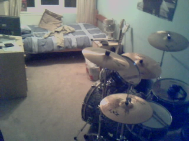

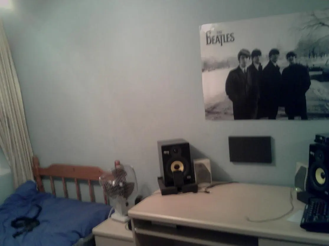

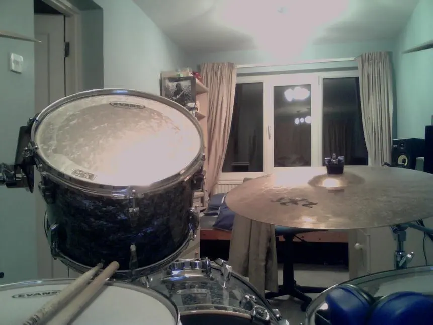

Ok, ive been recording in my bedroom for a while now, however the room has no treatment and is very small for recording drums and i need some help in choosing what treatment would help with creating a good recording environment for recording mainly drums and guitars. The room is a rectanglular shape with a carpeted floor 5.5 meters long, 2.3 meters wide and has a 2.2 meter high ceiling. The drums are on their own at one end, the mixing posistion is the middle of the room against the long wall and my bed, tv, bookshelf etc are all at the opposite end of the room to the drums. Ive tried to attach some pics, hope they uploaded ok.
Anyway, I know this room is not ideal and the mixing position is not good however could anyone suggest a way i could treat the room 1) for tracking and 2) for mixing, although im more interested in getting a good recorded sound to start with as there is a possibility to mix elsewhere. Please suggest some practical solutions remembering that this is my bedroom and some things will not be possible, any good ideas for a better mixing position would be appreciated but, keep it realistic!

Putting your desk where your bed or drums are now would help a lot, especially with that curtain on the back and front walls. :D
I would, if possible, install bass traps in the 4 corners. If this is not possible, the wall-ceiling corners will work well too. Also treat your first reflection points (side and ceiling).
You could build some (i use 4) gobos for placing around the drums, and 2 ceiling clouds above drums.

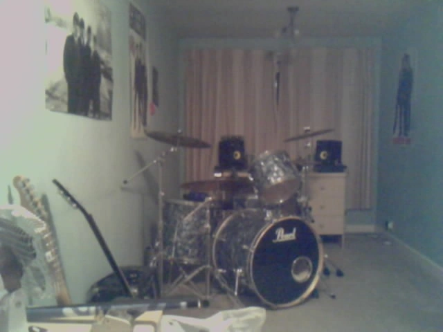

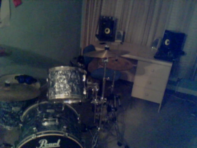

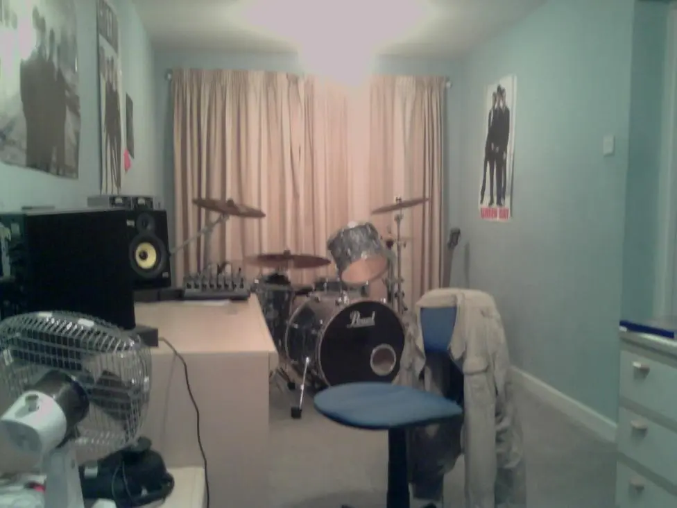

Ok, Ive moved some stuff around, now the desk is at the from of the room , pointing down the length of the room. There is now a gap of about 500mm between the monitors and the window, and i can shut the curtains behind them (would this be a better idea??)
atm, the drums are squashed to the side, but for recording would prob be moved more into the middle of the room.
Now, I plan to get some acoustic treatment. Im thinking of buying some 350 square tiles which i can mount on thin board, prob 2x3 tiles per board. Ill try and make 4 to start with and see what it sounds like. Will get some bass traps for the corners, and maybe make some gobos using foam and the bottom half of a cheap mic stand as the bass...good idea????

That's a lot better. Yeah, i'd keep all curtains shut during recording. The only foam i'd suggest is auralex, although it's really expensive, i wouldn't trust anything else.
Instead of foam, you can build your own absorption panels (broadband, bass traps and gobos) with rigid fiberglass (I'm from the UK and used 2" Knauf Rocksilk RS45 which can be ordered from good builders merchants for around £20-30 for 10). To build them, make a wooden frame, either around or behind the fiberglass, then wrap the whole thing in fabric.
For broadband and gobos 2" should be fine, but for the bass traps, doubling to 4" would be best.
