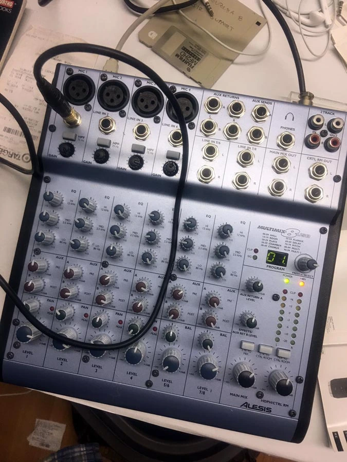

Any suggestions? I'm going to try and upload some pictures of the mixing board itself.

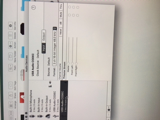

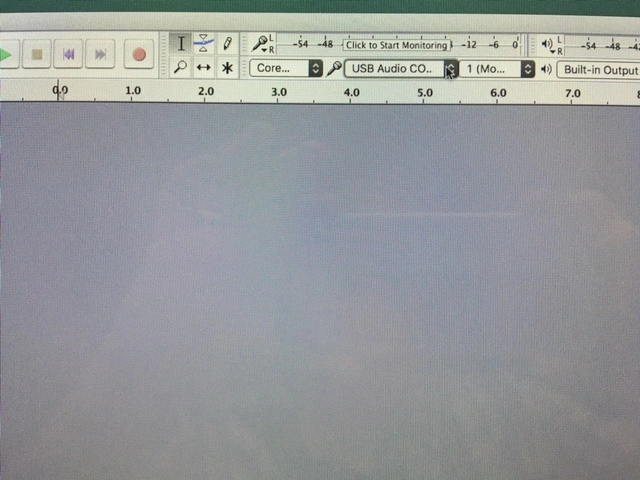

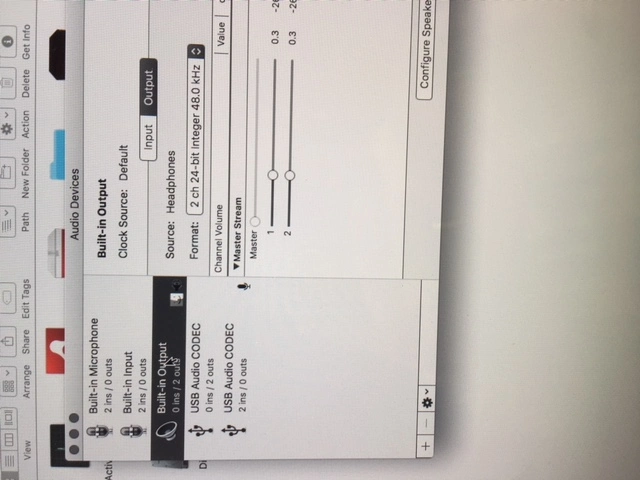

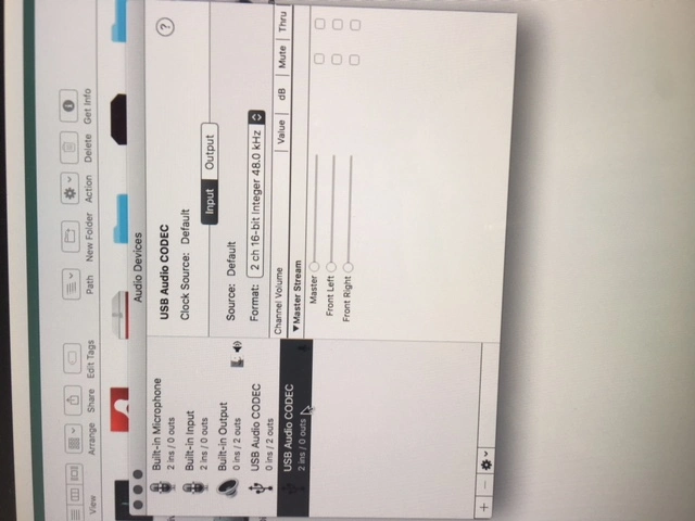

Hi
I have adjusted everything to 48 and the problem persists. Here are some screen grabs of my set up, from Audacity to MIDI set up. Anyone see anything wrong?
Thanks
Dean

Shouldn't make a difference, I don't think, but set the Built-in Output to 2ch 16 bit @ 48, just to match the USB device.
Your images don't show Settings for 'USB Audio CODEC' : The one with '2 outs'.
I know you're not presently using the mixer as an output device, but set it the same as everything else anyway.
If the problem persists I'd tell Audacity to use the USB mixer for input and output, and plug your headphones into the mixer, for testing if nothing else.
Edit : It looks like Audacity lets you set sample rate per-track, regardless of the device settings.
Seems unusual, but make sure that's 48k too.
You can also set the defaults in Audacity Preferences->Quality
