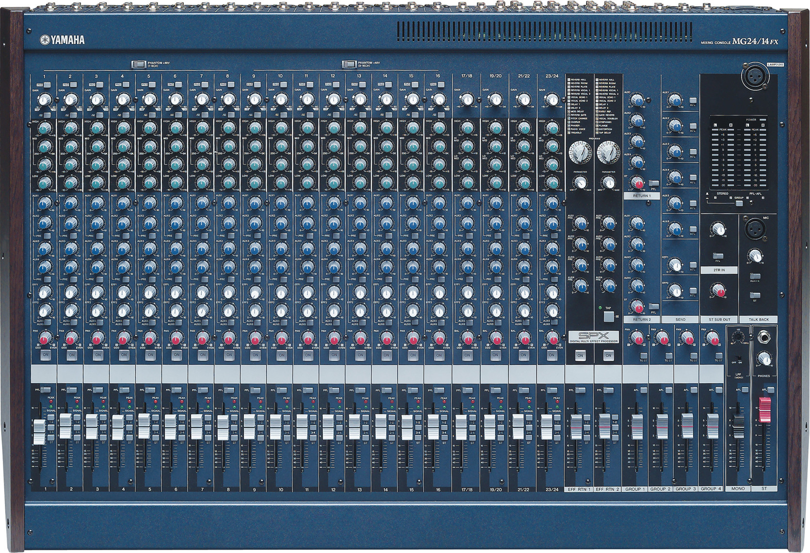

Some mixers may not have trim or gain on line-in's, but some do - on the Tascam 2488, the 4 line inputs have additional gain controls to boost signals further if need be. The Yamaha MG24, for example, has gain control on the stereo input channels, which I believe are configured to only accept line-level inputs:
http://www.sweetwater.com/images/items/1800/MG24-14FX-xlarge.jpg
