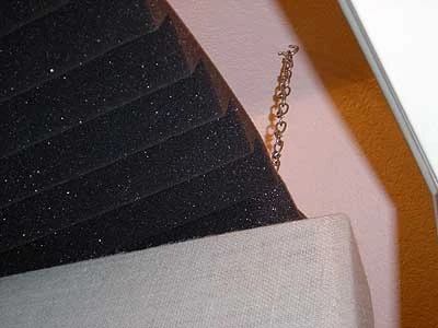

Here's what I did in my vocal closet. 3 panels of 4" 703 wrapped in burlap, hinged together, and suspended from the ceiling by chain. About 45 lbs of total weight. I threw a sheet of Auralex that I had laying around to catch SOME of the high frequencies that might go up and to also dim the lighting for mood.
I also made the panels totally detachable from the chains so that I could move them into the room for amp recording.

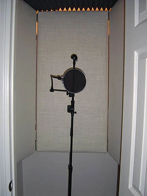

Here's another picture...

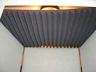

And another one...

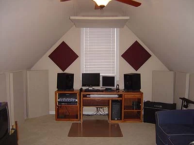

And just the front of the "studio"...I'm adding a triggered drum kit shortly.
I'm concerned about the light above the auralex in the closet-- otherwise, looks awesome!
I thought about that...but it doesn't get that hot. There's more distance between the light and the foam that the picture shows. Don't know what else to do. Isn't Auralex supposed to be flame retardant? :D
